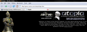

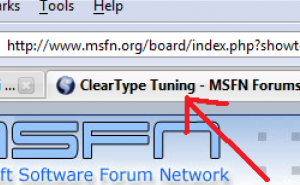

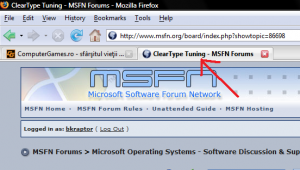

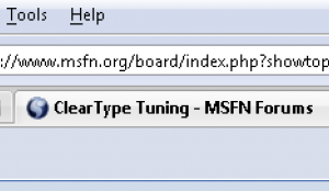

dAbReAkA: Can't you notice the reddish and greenish tints all around the bolded text? I don't have XP installed any more so I can't post screenshots.
Screemer: thanks, but that link doesn't work for Vista.
First image is with ClearType, zoomed to 400%, 2nd image is the same thing with ClearType disabled.

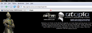

Here's another example. First image with ClearType on, there's a clear greenish tint to the whole text on the page, while the 2nd image with no ClearType has no greenish tint.
