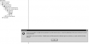

When trying to access the computer WinXP SP2 called TOMI from another computer in our LAN I get the following error:

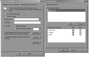

And this is how the share on the computer called TOMI is set up:
What am I doing wrong, since I've done this thousands of time and it always worked. What is wrong now?

Check your NTFS permissions (the Security tab). They are separate from the sharing permissions.

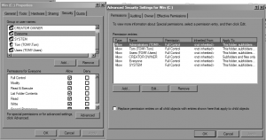

Here's a screenie of my settings:
Edited by BigDaddy
Ensure that none of those other entries have DENY checked. Deny overrides Allow.

  • Author
U just gave me the idea! Since I have a passwordless login WinXP SP2 automaticly denies all access to drives. And thus I had to change GPEDIT.MSC LIMIT LOCAL ACCOUNT USE OF BLANK PASSWORDS TO CONSOLE ONLY to FALSE
and now it works
