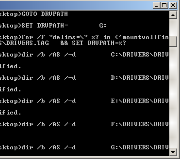

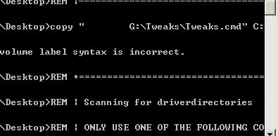

spacesurfer Posted September 8, 2006 Author Posted September 8, 2006 Yzowl and jaclaz, this is the error I get with Yzowl's script using mountvol. I modified the script a bit for my unattended to look for win51 and drivers.tag:REM NEW SEARCH FOR CD-ROM DRIVEREM -----------------------for /f "delims=\" %%? in ('mountvol^|find ":\"') do dir/b/-d %%?\WIN51 &&SET CDDRIVE=%%?ECHO.GOTO DRVPATHREM SEARCH FOR DRIVERS PATHREM -----------------------:DRVPATHSET DRVPATH=%CDDRIVE%for /f "delims=\" %%? in ('mountvol^|find ":\"') do dir /b /AS /-d %%?\DRIVERS\DRIVERS.TAG &&SET DRVPATH=%%?ECHO.goto STARTSETUPHere are the screens that show the extra spaces:This one shows the spaces before the drive letter assignment and after the dir command:This one shows the spaces in the echo command:And this one results in an error when I try to copy tweak.cmd to %systemroot%:Any ideas on what can be causing this?I probably will just have to use the for %%x in (c d e f g ....) and do the loop de loop thing.
Yzöwl Posted September 8, 2006 Posted September 8, 2006 (edited) Yzowl and jaclaz, this is the error I get with Yzowl's script using mountvol. I modified the script a bit for my unattended to look for win51 and drivers.tag:<snip>Point of noteThis is not my script 'modified a bit', in fact the only bit that really bears any resemblence is:%%? in ('mountvol^|find ":\"') do<Re-Edit>Here is one way of doing it, which has been simplified and may therefore be easier to understand@ECHO OFF &SETLOCAL ENABLEEXTENSIONSSET "DCT=DRIVERS" &SET "FIL=DRIVERS.TAG"FOR /F %%? IN ('MOUNTVOL^|FIND ":\"^|FIND /V "A:\"') DO (IF EXIST %%?WIN51 ( IF EXIST %%?%DCT%\%FIL% (SET DRVPATH=%%?%DCT%)))IF DEFINED DRVPATH (ECHO/%DRVPATH%) ELSE (ECHO/TAGFILE NOT FOUND)ENDLOCAL &GOTO :EOFYou can remove the red text after testing if you so wish</Re-Edit> Edited September 8, 2006 by Yzöwl
