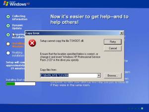

NtegrA Posted June 7, 2006 Posted June 7, 2006 (edited) 1. Somewhere between HFSLIP_60317.CMD and HFSLIP_60528.CMD, HFSLIP has broken down on me. with 60317 I was getting file copy errors due to duplicate entries in TXTSETUP & DOSNET. removing the dupe entries (all after hfslip entries) gave clean install. Just updated my HFs, and since updating to 60528 and above I cannot complete setup with failing in gui with not finding TSHOOT.DLL & BNTS.DLL. I don't know what you need so attached is screen shots, log, txtsetup, dosnet. let me know if additional info is needed.2. no longer need "I HAVE READ THE INSTRUCTIONS" in CAPS.3. can "C" be added in drive check in HFSLIP.CMD (SVCPACK)? I copy my I386 to the HD and install from there. "FOR %%i IN (C D E F G H I J K L M N O P Q R S T U V W X Y Z) DO"4. I think that's all I got. GREAT APP!!!! Edited June 8, 2006 by NtegrA

Tomcat76 Posted June 8, 2006 Posted June 8, 2006 The only problem I see in the zipped files is one related to the WU Catalog engine (IUCTL.CAB) which will be rectified in the next test release. But "tshoot.dll" is present in both DOSNET.INF and TXTSETUP.SIF so the problem doesn't lie there. Is the file present in your I386 folder?
NtegrA Posted June 10, 2006 Author Posted June 10, 2006 (edited) The only problem I see in the zipped files is one related to the WU Catalog engine (IUCTL.CAB) which will be rectified in the next test release. But "tshoot.dll" is present in both DOSNET.INF and TXTSETUP.SIF so the problem doesn't lie there. Is the file present in your I386 folder?Yes the file is present along with the other file (TSHOOT.DL_ & BNTS.DL_) that setup is complaining about. These files are also already in \WINDOWS\HELP when the errors occur.@TommypI will try deleting the folder and rerunning hfslip. will post results this evening. Edited June 10, 2006 by NtegrA

NtegrA Posted June 13, 2006 Author Posted June 13, 2006 Well it looks like I may have found the answer to my problem after some LOOOOOONNGGGG TEEEDDDDDIIIIOOOUUUUSSS searching on this site...It's funny how you can search for "gui missing files" and find nothing but search for "missing files" or "gui missing" and maybe find what you are looking for...I found a post on this site that sent me to Ryanvm's site and the following post:http://www.ryanvm.net/forum/viewtopic.php?t=1653Specifically the section where he adds the following to txtsetup.sif:Here's what I added into my FileFlags section: BNTS.DLL = 16 TSHOOT.DLL = 16 SNIFFPOL.DLL = 16 SSTUB.DLL = 16 SSDPSRV.DLL = 16 SSDPAPI.DLL = 16 UPNP.DLL = 16 UPNPHOST.DLL = 16 UPNPCONT.EXE = 16 UDHISAPI.DLL = 16 SAPICPL.HLP = 16 SPEECH.CHM = 16 So far I only added the first two lines as a test, and it produces more errors as, so I will try with the complete list. Is this something that HFSLIP could possibly handle (if it works) or would this strictly be left as a user initiated manual change only? HEH.Thanks again for an excellent app(?) script(?) whatever(?)

NtegrA Posted June 14, 2006 Author Posted June 14, 2006 OK, so... adding those lines to txtsetup.sif seems to have fixed the missing file problem. I am going to re run it again just to be sure.Unrelated to previous problem. I am having problems with hotfix KB887472 (MS05-009). From my very first attempt to slip that bad boy into my install, MSBSA 2.0 claims that it's not installed.AND last but not least.. Any answer to #3 in my original post?@Tommyp - I was just thinkinnnnn. I got a couple extra appendages that could be useful...
