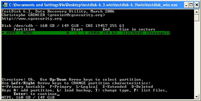

Carquip Posted March 26, 2006 Author Posted March 26, 2006 I ran ntfsdos & it found my 2 300gig drives but not my 160gig.All of a sudden, windows now recognizes the 2 300s, but not the 160gig.I ran "TestDisk" & it found the 160gig.
Carquip Posted March 27, 2006 Author Posted March 27, 2006 I ran "TestDisk" all the way through & had it re-write the patition table & now everything is back to normal.Don`t know what happened to the 300gig drives, but they are working now. Didn`t do anything to them. Weird!!!!.Maybe the IDE controller on my Mobo is acting up?. Time for a new Box I think.Thanks to all for your help.
