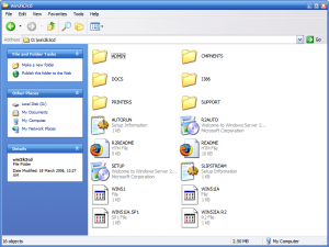

Lemonzest Posted March 18, 2006 Posted March 18, 2006 (edited) what i did is extract the root of CD2 into the root of CD1 so that so that WIN52IA.R2 is with the other ID files (Along with the other files and folders, overwrite any files it says, (only two autorun.ini and one other), when it is installed just click next on the R2 install box that appears and then it will continue ,the ISO is just under 700MB (695MB) and fits on one 80min CDR, no idea how to install the R2 components unattended Edited March 18, 2006 by Lemonzest
