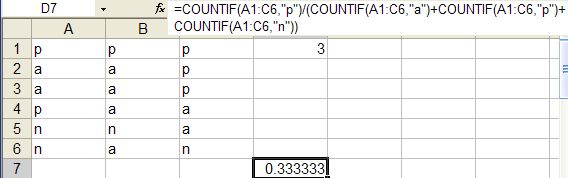

can I simplify this formula: =COUNTIF(G3:GG3;"p")/(COUNTIF(G3:GG3;"p")+COUNTIF(G3:GG3;"n")+COUNTIF(G3:GG3;"a"))
it says: Give me the number of P and divide it by the total number of time the letter P,A,N are shown

Actually it is possible by enclosing the formula in an IF statement, using the ISERR function:
This will give 0 if an error is the result:
=IF(ISERR(COUNTIF(G3:GG3;"p")/(COUNTIF(G3:GG3;"p")+COUNTIF(G3:GG3;"n")+COUNTIF(G3:GG3;"a")));0;COUNTIF(G3:GG3;"p")/(COUNTIF(G3:GG3;"p")+COUNTIF(G3:GG3;"n")+COUNTIF(G3:GG3;"a")))
This will give blank if an error is the result:
=IF(ISERR(COUNTIF(G3:GG3;"p")/(COUNTIF(G3:GG3;"p")+COUNTIF(G3:GG3;"n")+COUNTIF(G3:GG3;"a")));"";COUNTIF(G3:GG3;"p")/(COUNTIF(G3:GG3;"p")+COUNTIF(G3:GG3;"n")+COUNTIF(G3:GG3;"a")))
This will prevent ONLY #DIV/0!:
=IF((COUNTIF(G3:GG3;"p")+COUNTIF(G3:GG3;"n")+COUNTIF(G3:GG3;"a"))=0;"";COUNTIF(G3:GG3;"p")/(COUNTIF(G3:GG3;"p")+COUNTIF(G3:GG3;"n")+COUNTIF(G3:GG3;"a")))
I am sure you get the idea...
