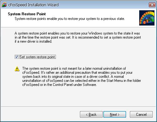

johndoe74 Posted March 24, 2008 Posted March 24, 2008 (edited) radix have you turned off system restore on your windows ? because with your script the installer stops at the system restore point. please check and thanks for the help Edited March 24, 2008 by johndoe74
radix Posted March 24, 2008 Posted March 24, 2008 (edited) radix have you turned off system restore on your windows ? because with your script the installer stops at the system restore point. please check and thanks for the helpIt's turn off.That window appear if System Restore is turn on (turn off is unchecked).I will upload a new version when I come back from work. Edited March 24, 2008 by radix

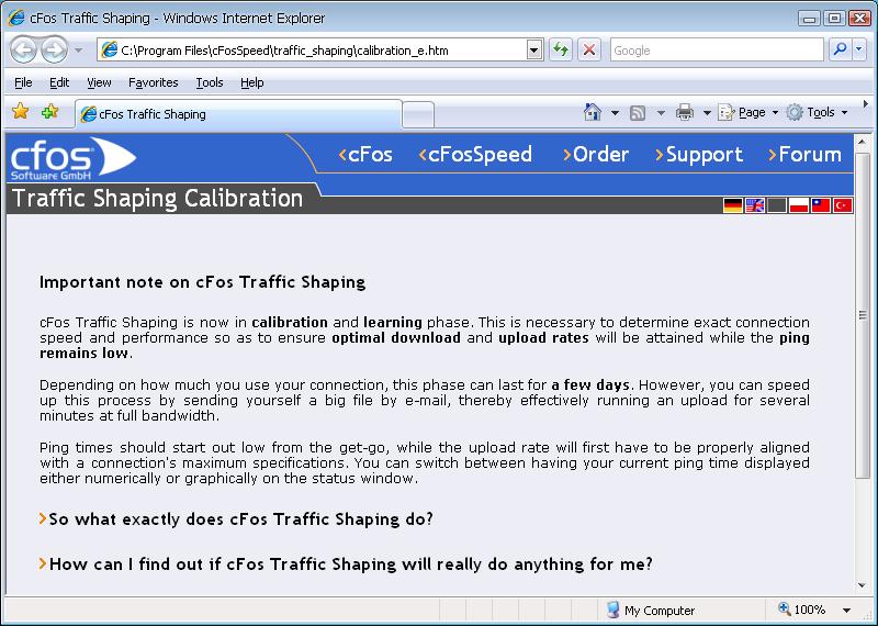

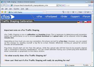

johndoe74 Posted March 24, 2008 Posted March 24, 2008 hi radix, thanks for the update. installation progresses just fine but at the end, the the traffic shaping internet explorer window pops up!

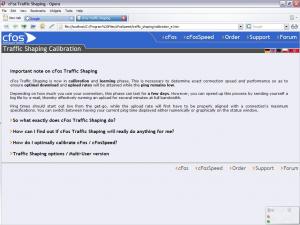

radix Posted March 24, 2008 Posted March 24, 2008 (edited) hi radix, thanks for the update. installation progresses just fine but at the end, the the traffic shaping internet explorer window pops up!That window doesn't appear to me.But something similar pops up when I turned internet connection on and then launched Opera. Edited March 24, 2008 by radix
radix Posted March 24, 2008 Posted March 24, 2008 (edited) Try again. cfosspeed 4.20.1389 32 Bit version:Opt("TrayIconDebug", 1)Opt("SendKeyDelay", 200); Executable file name$EXECUTABLE = "cfosspeed-v420.exe"; Installation folder$INSTALLLOCATION = @ProgramFilesDir & "\cFosSpeed"; Set system restore point$RestorePoint = "0"; Optimize TCP receiver window size$Optimize = "1"; Registration; If you want to try cfosspeed for 30 days, let $Registration = "0". Else set $Registration = "1" and read below.; In order to register cfosspeed silently, you need to install cfosspeed, copy key file into installation folder; and reboot computer. After logon, when cfosspeed start, enter the password.; Then goto this registry key: HKEY_LOCAL_MACHINE\SOFTWARE\cFos\cFosSpeed and copy the value from valuename Password2 below; at $Password without commas and backslash. Copy your key file in the same folder with installer and compiled script and repack.$Registration = "0"$KeyFileName = "key.cfosspeed"$Password = ""; Run cfosspeed on Windows startup$Autostart = "1"If FileExists($INSTALLLOCATION & "\cfosspeed.exe") Then MsgBox(0x40010, @ScriptName, "Please uninstall previous version of cfosspeed before using this script", 4) ExitEndIf; Read from registry if System Restore is turn on or off$DisableSR = RegRead("HKLM\SOFTWARE\Microsoft\Windows NT\CurrentVersion\SystemRestore", "DisableSR"); Run the installerRun($EXECUTABLE); Welcome to cFosSpeed v4.20!WinWait("cFosSpeed Installation Wizard", "Welcome to cFosSpeed v4.20!")WinActivate("cFosSpeed Installation Wizard", "Welcome to cFosSpeed v4.20!")ControlClick("cFosSpeed Installation Wizard", "", "Button2"); cFosSpeed 4.20.1389 Nutzungslizenz und GewährleistungWinWait("cFosSpeed Installation Wizard", "cFosSpeed 4.20.1389 Nutzungslizenz und Gewährleistung")WinActivate("cFosSpeed Installation Wizard", "cFosSpeed 4.20.1389 Nutzungslizenz und Gewährleistung")ControlCommand("cFosSpeed Installation Wizard", "", "Button1", "Check", "")ControlClick("cFosSpeed Installation Wizard", "", "Button3"); Start checking for two windows with "Set system restore point." and "You are online with the following connection:" text insideAdlibEnable('_Adlib'); Specify an installation directory.WinWait("cFosSpeed Installation Wizard", "Specify an installation directory.")WinActivate("cFosSpeed Installation Wizard", "Specify an installation directory.")If $DisableSR = "0" Then ControlClick("cFosSpeed Installation Wizard", "", "Button5")EndIfIf $DisableSR = "1" Then ControlClick("cFosSpeed Installation Wizard", "", "Button4")EndIf; Optimize TCP receiver window size. (Recommended)WinWait("cFosSpeed Installation Wizard", "Optimize TCP receiver window size. (Recommended)")WinActivate("cFosSpeed Installation Wizard", "Optimize TCP receiver window size. (Recommended)")If $Optimize = "0" Then ControlCommand("cFosSpeed Installation Wizard", "", "Button1", "UnCheck", "")EndIfIf $DisableSR = "0" Then ControlClick("cFosSpeed Installation Wizard", "", "Button7")EndIfIf $DisableSR = "1" Then ControlClick("cFosSpeed Installation Wizard", "", "Button6")EndIf; Installation successful.WinWait("cFosSpeed Installation Wizard", "Installation successful.")WinActivate("cFosSpeed Installation Wizard", "Installation successful.")If $DisableSR = "0" Then ControlClick("cFosSpeed Installation Wizard", "", "Button8")EndIfIf $DisableSR = "1" Then ControlClick("cFosSpeed Installation Wizard", "", "Button7")EndIf; Stop checking for two windows with "Set system restore point." and "You are online with the following connection:" text insideAdlibDisable()Sleep(2000); Kill browser process$PID = ProcessExists("IEXPLORE.EXE")If $PID Then ProcessClose($PID)EndIf$PID = ProcessExists("Opera.exe")If $PID Then ProcessClose($PID)EndIf$PID = ProcessExists("firefox.exe")If $PID Then ProcessClose($PID)EndIf; RegistrationIf $Registration = "1" Then FileCopy($KeyFileName, $INSTALLLOCATION, 1) RegWrite("HKLM\SOFTWARE\cFos\cFosSpeed", "Password2", "REG_BINARY", $Password)EndIf; Block cfosspeed to run on Windows startupIf $Autostart = "0" Then RegDelete("HKLM\SOFTWARE\Microsoft\Windows\CurrentVersion\Run", "cFosSpeed")EndIf; Delete shortcut cFosSpeed Features from Desktop folderFileDelete(@DesktopDir & "\cFosSpeed Features.lnk")Func _Adlib(); Set system restore point. If WinExists("cFosSpeed Installation Wizard", "Set system restore point.") Then WinActivate("cFosSpeed Installation Wizard", "Set system restore point.") If $RestorePoint = "0" Then ControlCommand("cFosSpeed Installation Wizard", "", "Button1", "UnCheck", "") EndIf ControlClick("cFosSpeed Installation Wizard", "", "Button4") EndIf; You are online with the following connection: If WinExists("cFosSpeed Installation Wizard", "You are online with the following connection:") Then WinActivate("cFosSpeed Installation Wizard", "You are online with the following connection:") ControlClick("cFosSpeed Installation Wizard", "", "Button1") If $DisableSR = "0" Then ControlClick("cFosSpeed Installation Wizard", "", "Button6") EndIf If $DisableSR = "1" Then ControlClick("cFosSpeed Installation Wizard", "", "Button5") EndIf EndIfEndFunc Edited March 25, 2008 by radix
