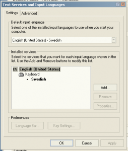

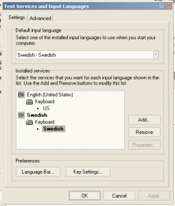

pawls Posted December 31, 2005 Posted December 31, 2005 Hi,I´m having trouble getting my RegionalSettings/Language set up the way I want it. Hopefully someone can give me some help or directions.This is what I have:This code:[RegionalSettings]LanguageGroup = 7,1SystemLocale = 00000409UserLocale = 0000041dInputLocale = 041d:0000041dgives me theese settings:But I would like it to be like this:What code would reproduce that?Best, Hugo
