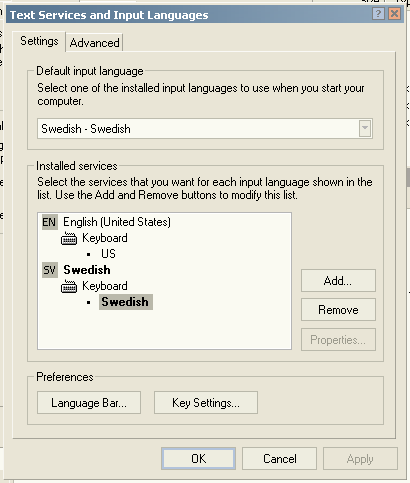

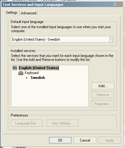

  3. You could create a folder named 'USB' on the pendrive and then use this code to detect on wich drive it resides. FOR %%i IN (C D E F G H I J K L M N O P Q R S T U V W X Y Z) DO IF EXIST %%i:\USB set USB=%%i: Now, %USB% = pendrive:\

  6. Thank you Vadikan! Thank you Takeshi! I´ll try Takeshis tip, if it works it´s a far more easier solution. Why I want this keyboard/language setup is because I want all my applications being installed with english as default language, not swedish. Is there any other tips/solutions to prevent other langages from being chosen by the applications?
