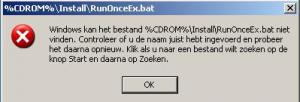

Steffen Posted October 16, 2005 Posted October 16, 2005 [GuiRunOnce]"%CDROM%\Install\RunOnceEx.bat"That rule in standing in the file winnt.sifBut i get the error that I have attached in this topiccan somebody help me ??
Asin Posted October 16, 2005 Posted October 16, 2005 You can at least add a sentence to that post.Although I've used the %CDROM% environment variable myself before for batch files for upgrade CDs that include SP2 and post-SP2 updates without complaints, from what I've seen on this forum, it's not a real environment variable that works in XP without setting it up. The problem might be the use of the %CDROM% environment variable.What you could do is put your batch file in your $OEM$ folder which would then be copied to the hard drive. Then just change the command to use C:\ instead.Otherwise, change your [GuiRunOnce] section to look like this and try again:[GuiRunOnce]Command0 = "%CDROM%\Install\RunOnceEx.bat"
InTheWayBoy Posted October 16, 2005 Posted October 16, 2005 Yeah, there is no default %CDROM% or %CD% variable that points to an optical drive. You can run a few lines of code to establish a variable...I never use it so I don't know it, but I know there was a similar post a while back that had the answer in it. You can search for it...

aussiecanuck46 Posted October 17, 2005 Posted October 17, 2005 Try renaming RunOnceEx.bat to RunOnceEx.cmd. I've read somewhere in MSFN that the file extension is important.To try to debug why applications aren't being installed using the RunOnceEx method...after the installation fails, manually execute the RunOnceEx.cmd file again, then look at the RunOnceEx entries in the registry to see what actually was applied. This will reveal whether the %CDROM% substitution was done as you want it to be.Once you've figured out what the trouble is, and made adjustments to the registry entries, you can re-test without re-installing by issuing:rundll32.exe iernonce.dll,RunOnceExProcess from the Command line. This will install your applications lodged in the RunOnceEx part of the registry.
Asin Posted October 17, 2005 Posted October 17, 2005 If the %CDROM% environment variable needs to be set in order for it to work, doesn't it then make sense that it's only temporary and will probably no longer work after a restart?Would it work if you add a batch file to the beginning of your list of things to do after the first login that sets the %CDROM% variable again?

Steffen Posted October 17, 2005 Author Posted October 17, 2005 is there not a code that you can set under the [GuiRunOnce] section in winnt.sif that sets the %CDROM% variable "on"?? SO i can use it...please help
aussiecanuck46 Posted October 17, 2005 Posted October 17, 2005 The %CDROM% variable is user-defined, not permanent. Your fixation with SATA drives being a problem is not relevant. You can use all the methods described in this forum to load drivers and programs, using the $OEM$ maps. Free your mind and your a** will follow.
