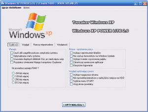

But for those interested in XP POWER LiTE 1.74 what ever it might be here's all the information I have...
it's a compressed installer that contains:
· NTDETECT.COM 47Kb
· NDLDR 272Kb
· four "reg" files: 1.reg, 64.reg, 128.reg, 256.reg, 512.reg
· power.bat

Looking it over, I thought, big deal - just removes useless crap.
Shuts down indexing service, drive performance monitoring, removes cache's and defrags the HD. I didn't think that the replacement of the boot code would do much. Based on comments elsewhere on MSFN, I thought I would do a test on
my home machine. It has always been slow booting.
WOW.
Measuring (one test only) the boot time from power-on to desktop -WITH NO HOURGLASS - the before and after time decreased by a little over 20 seconds.
Doesn't seem like much to say 20 sec, but it sure FEELS like a lot when you are waiting to begin.
I already keep my box defraged with several diff pgm's and have ample space, and disabling zip folder viewing seems stupid, so the rest of the bat (badly written)
is of no interest to me.
Think I will look thru the reg files again, though.

I am author Windows XP POWER LiTE. I come from Poland and this is my Project :yes:
I copy 2 fieles {NTLDR and NTDETECT.COM} from Windows 2k3 server (Non-SP) install CD and moded for Windows XP.
This 2 fieles is loader, system working fine in new memory controler. But this controler + OverClocking Memory is not good idea / system freeze :blushing: .
In Windows XP PLD (scr. POWER LiTE) 1.74 is v.1.10 in my new program Windows XP PLD 2.0 is v.1.12.
More info and homepage PLD http://www.xplink.pl
Quick test v.1.12
Windows XP Memory Controler - WinWord start (5-8 sec)
Windows XP@2k3 Memory Controler - WinWord start (1-3 sec)
Edited by Piterniel
i would like to make a request please
a copy of your program written in english so i can figure out what its all saying, and/or what to click to press to get 2k3 memory controller until you can make changes so i can see english in the program
Hi! I'm also from Poland and I'm helping LiTE in translating this program :)
I just finished translating , so LiTE must be only enter changes into the program ;)
