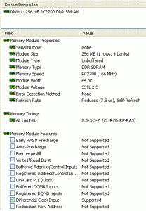

BombaTwist Posted July 6, 2005 Author Posted July 6, 2005 (edited) hmm, thats wierd, it must not be my EXACT mobo since i just checked what speed my current ram stick is and its DDR333 (PC2700).EDIT: but then again my ram stick is supposed to be 256mb but XP reads it only as 224mb which is really wierd =/ Edited July 6, 2005 by BombaTwist

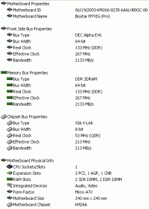

BombaTwist Posted July 6, 2005 Author Posted July 6, 2005 not sure if this will help much but here it is anyways
ssmokee Posted July 6, 2005 Posted July 6, 2005 hmm, thats wierd, it must not be my EXACT mobo since i just checked what speed my current ram stick is and its DDR333 (PC2700).<{POST_SNAPBACK}>DDR 400/333 will run at DDR 266 speeds just fine.EDIT: but then again my ram stick is supposed to be 256mb but XP reads it only as 224mb which is really wierd =/<{POST_SNAPBACK}>That motherboard has onboard video which uses system RAM. 32MB of it in your case, which is why XP is saying you have 224. The chipset that board uses doesnt have a dual channel memory controller either, not that it is really a big deal on an AXP board anyway.
