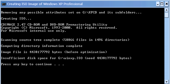

it stop process I don't know why??I have more space 10GB on drive G.
my command is:
CLS
@echo off
TITLE Creating ISO Image of Windows XP Professional
ECHO.
ECHO Removing any possible attributes set on G:\XPCD and its subfolders...
attrib -R -H G:\XPCD /S /D
ECHO.
ECHO Creating ISO...
CDIMAGE.EXE -lWXPFPP_EN -t12/31/2002,12:00:00 -h -j1 -m -o -bxpboot.img G:\XPCD G:\winxp.ISO
ECHO.
PAUSE
EXIT
show me that:
it says it needs 4232mb and probably you don't have that disk space available.
cdimage doesn't detect which is going to be the new image size, it just "needs" that amount of space.

cdimage will write everything to an iso first, then optimize it. So it will need the full amount of disk space prior to optimization. After optimizing it, it should take all the bloat away.
i had the same problem, so i convert to NTFS, and now i can make my iso without any trouble...
maybe its that? :unsure:
  • Author
you convert system drive or drive path to make iso?
In your case, drive G: needs to be NTFS, otherwise the image can't be created.

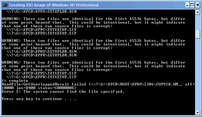

yap is work ,i know why show error for bin sif files.but see last error ,what happen why i can make iso?
  • Author
Still no one know how fix it error ?
In the above screenshot, that error seems like:
1. Either its a file got from a network location or CD-rom drive and now can't be read due to some reason.
2. Its a file on HDD unreadable due to disk errors - run scandisk and confirm that all is fine.
