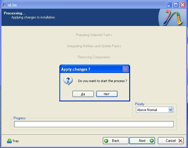

userus Posted March 14, 2006 Posted March 14, 2006 If i do 1. Copy clean i3862. Run Nlite RC73. Load my conf to Nlite, press next, next... "Apply changes?" i dont do anythig !!4. Run manually UpdatePack-XPSP2-Rus(update pack for rus windows(ryan)) 5. UpdatePack-XPSP2-Rus is integrated OK6. "Apply changes?" press yes7. Nlite do his jobs OKI have this problemBut if i do Run UpdatePack-XPSP2-Rus(update pack for rus windows(ryan)) first (do not run Nlite) after Run Nlite -> all OK !
nuhi Posted March 15, 2006 Posted March 15, 2006 userus, and you find that weird?You see update packs have some files which nlite updates but if you overwrite with update pack after nlite done it job once there will be a problem.
userus Posted March 16, 2006 Posted March 16, 2006 (edited) Update dont overwrite any files after nlite do his job, updatepack always run before nlite START HIS JOB i dont press button YES in window "apply changes".How is work nlite - scan windistr -> configuring - > show window "Apply changes?" -> if YES strat jobI dont press YES in window "Apply changes?", nlite do not any changes, i press YES only after update integratedps. may be i'm stupid, or dont understand english? Edited March 16, 2006 by userus

userus Posted March 17, 2006 Posted March 17, 2006 Ok 1. copy clean distr2. run nlite, configuring3. press next next... while not see attached window4. NOT PRESS YES(KEEP IN BACKGROUND)5. run updatepack manually6. when updatepack is finish 7. PRESS YES in attached window8. have this problemps. My english is too bad and i can not explain in detail

userus Posted March 20, 2006 Posted March 20, 2006 (edited) I more detailed tested nLite and i found this problem1. If i try apply only Tweaks, nLite do not change txtsetup and dosnet -> error missing nLite.inf and Srclient.dll2. Call nLiteRF=ocgen.dll,OcEntry,nLite.inf,HIDE,7 from sysoc not work(he cnt work)3. reason of my problem with UpdatePack-XPSP2-Rus, at moment of presence window "Apply changes?" nLite lock files txtsetup sysoc... , and UpdatePack-XPSP2-Rus can't change them, i don't know continues nLite lock this file when he itgrated Ryn automatic if yes -> error4. HKLM,"SOFTWARE\Microsoft\Windows\CurrentVersion\RunOnce","nlreg",0x00020000,"rundll32 advpack.dll,LaunchINFSection %SystemRoot%\inf\nlite.inf,T" I thought that this section from hivest will be added to registry, BUT on T34 windows RUN immediately this "rundll32 advpack.dll,LaunchINFSection %SystemRoot%\inf\nlite.inf,T"(try install calc.inf)from sysoc nLite section work correct, i think not it is necessary to start form hivesft, all strings from RunOnce run on T13, some tweaks will be overwriten later(crashcontrol tweaks not work).After nLite i have this strings in nLite.inf[nLiteRF]OptionDesc = "nLite"Tip = "Windows component removal adjustments and tweaks."Modes = 0,1,2,3AddReg = SHKLM,"SOFTWARE\Microsoft\Windows\CurrentVersion\RunOnce","nlreg",0x00020000,"rundll32 advpack.dll,LaunchINFSection %10%\inf\nlite.inf,nLiteReg"what is %10% may be %systemroot%i think -> need add HKLM,"SOFTWARE\Microsoft\Windows\CurrentVersion\RunOnce","nlreg",0x00020000,"rundll32 advpack.dll,LaunchINFSection %systemroot%\inf\nlite.inf,nLiteRF" to T or H C section in nlite.inf[nLiteRF]OptionDesc = "nLite"Tip = "Windows component removal adjustments and tweaks."Modes = 0,1,2,3AddReg = SHKLM,"SOFTWARE\Microsoft\Windows\CurrentVersion\RunOnce","nlreg",0x00020000,"rundll32 advpack.dll,LaunchINFSection %systemroot%\inf\nliteFinal.inf" nliteFinal.inf this is copy of nlite.inf without calling nLiteRF(nLite section rename to DefaultInstall )Result -> form sysoc apply nlite.inf,nlite -> on t13(work runonce) apply nlite.inf,nliteRF -> from nliteRF add to runonce nliteFinal.inf call ->= all tweaks enabledtry to setup calc.inf(Rbutton -> setup)from attached nlite.inf i have all tweaks are enabledto nowinscenario:MMC to come up as blank interfacesif I correct has understood your problem then answer here -> u apply Ryn(or other update) he contains in itself KB907265 which does not be friends with Xpize ! do not apply Xpize!NLITE.INFcalc.inf Edited March 21, 2006 by userus
