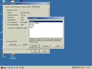

I tried applying the latest SP 1.6.3 to my Compaq LTE 5300 laptop which i installed a clean install of 98 onto it about 2weeks ago. After a fresh boot i was only left with 33% in system resources. Usually its 94% without the service pack. I'm suspecting this to be something to with with the PC-CARD manager. I currently hav a Xircom RealPort 10/100 16bit in the PCMCIA slot. The only additional program that loads at startup was MSN messenger 6.2. Prior to installing the service pack my laptop contained all updates from windows update.

I do have a copy of this program and i will attempt to re-install the SP and run this program, however i had trouble shutting down windows with only 33% in resources. i was unable to load the start menu so if im able to run this program i will post the log.

i think that cbss.vxd file u reffered me to is for cardbus, not standard PCMCIA as i could not find a previous version of this file on my system, and the one i extracted did not overite any files. however i rebooted and tried this and no difference.
found something else that was interesting as well. wen i went to system properties to check the resources again 3 times in 10 secs, each time the resources dropped by 15~% from the previous time. i ended up with 17% free!

This makes no difference. This experience is bringing back memories of my last encounter with windows me...crashes...low resources in white boxes...lockups....explorer reloads...
