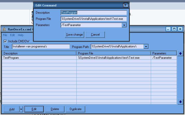

I'm using the RunOnceEx Creator and I added some softwarez to it but I'm still confuse about the path. E:\XPCD\$OEM$\$1\Install\Applications <-- this is where all the software that I've added in. So in the run once do I have to add %systemdrive%\install\Applications\programnamefolder\programe.exe ?? or wut? please help with clarification. Thank you.

before you realy add a command to the list, you have to make sure that the programfile field the directory contains in wich it is located. Meaning: Set in the mainscreen the ProgramPath to:
%SystemDrive%\Install\Applications\
In the Add Command window, make sure that the ProgramFile field contains the name of the folder in wich the setup of that program is located (See Screenshot), So no it is not intended that you place every executable in the folder you mention, but in seperate subfolders.
But when you start using my program. The first thing to do is to set the ProgramPath field on the main screen. it is not limited to those path that are on the list. you can type in it.
If you encounter more problems. please open a new topic, to keep this thread as clean as possible. (this goes for everyone, or else this topic will be a big mess and very dificult to read. no offense though).
P.S. The below screenshot is from the latest version. Do not pay attention to the colors, they are from my theme. The new version is NOT available yet. the latetst version is still 2.1.2.1
