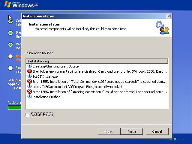

Maybe it looks like I am using Windows 2000 but I am not.
I am using Windows XP UK with SP1.
If I run WIHU at the T-13 mark using "WIHU.EXE /SkipSettings" all programs is installed fine.
This only happens when trying to create new user.
I have attached a screen dump of the error. You'll see that it is Windows XP.
And despite the errors about creating user, the user is created and the user is the one that auto logs in.

Status: 2, Default User is 'Booster', User Domain is '' as Group 1 (Flags = 0)
Status: 2, Creating/Changing user: Booster
Status: 0, Error 21: Shell folder environment strings are disabled. Can't load user profile. (Windows 2000: Enable SeTcbPrivilege privilege)
Status: 2, Tc603\Install.exe
Status: 0, Error 1355, Installation of "Total Commander 6.03" could not be started:The specified domain either does not exist or could not be contacted.

Status: 2, xcopy Tc603\wincmd.ini "C:\Program Files\totalcmd\wincmd.ini" /Y
Status: 0, Error 1355, Installation of "TC Settings" could not be started:The specified domain either does not exist or could not be contacted.
Status: 2, Installation finished.
This is run at T-13, will try next to run at RunOnceEx.cmd
But If I run it at clean install logged in as "Administrator" everything is fine.
Report back later when run from RunOnceEx.cmd.

Are you in a domain, if yes at T-13 there are no network stacks loaded i think, have to look this up. so therefore you could recieve this errors about "The specified domain either does not exist or could not be contacted..."
@booster: Very strange. Error 21 means "Device not ready" after calling "LoadUserProfile" API. May be calling this at T-13 stage isn't allowed?!

Status: 2, Default User is 'Booster', User Domain is '' as Group 1 (Flags = 10220)
Status: 2, "Total Commander 6.03" was executed.
Status: 2, "TC Settings" was executed.
This is run from RunOnceEx.cmd and all is fine..
No domain and no roaming profile.
Guess it's not supported at that stage..
Well. I just run it from the RunOnceEx.cmd, so no more worries Benjamin :)

PS: I found this about CMDLINES.TXT
Edited by booster
certain programs/instructions may not work, due to the unfinished state of the windows setup. An example is the NET USE command, which you cannot use, as the Workstation service has not been started, and is required by the NET USE command.
That's it :)
Benjamin
Well.. Now we know the cause  :)
