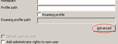

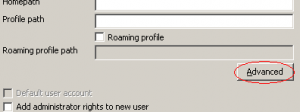

Please also take a look at the new "User Account Advanced Page". Please make any suggestions how this could be designed and also if I should add more features like:
- Account expiration time
- Max User storage
- Logon hours (currently in development)
- User Country id and code page
best regards
Benjamin Kalytta
