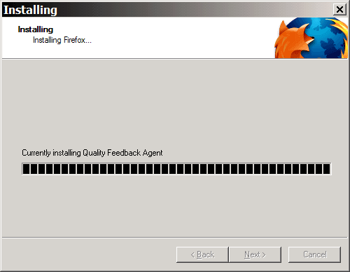

@996: i realized, modifying some settings under the config.ini file within the firefox 0.9 installer changes the behavior of the installation. im just unsure how it effects the installation process altogether... with some modifications of the config.in file, i was able to simply double click on the setup.exe and it bypassed all dialogs... except that it pauses at the part where it is installing the Quality Feedback Agent.
here are some settings i altered:
[General]
Run Mode=Auto
;Default is Normal
[Dialog Select Install Path]
Show Dialog=FALSE
;Default is TRUE
[Dialog Downloading]
Show Dialog=FALSE
;Default is TRUE
[Dialog Install Successful]
Show Dialog=FALSE
;Default is TRUE

You can disable the quality feedback agent QFA in config.ini also but check if it works first...

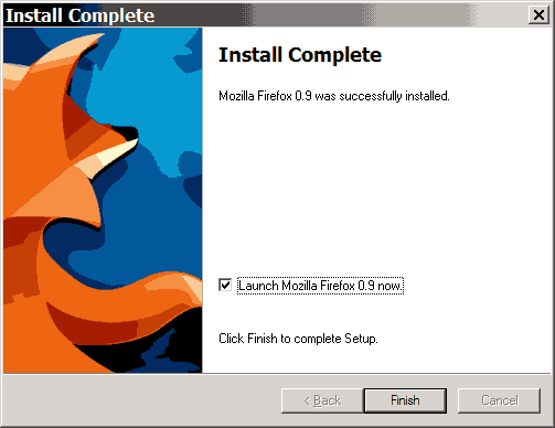

here though, i was able to skip using mozilla's setup.exe by combining the modified config.ini with an autoit script.
here's my autoit script:
AutoItSetOption("WinTitleMatchMode", 3)
Run(@HomeDrive&"\Others\firefox\setupff.exe")
WinWait("Install Complete")
BlockInput(1)
ControlCommand("Install Complete", "", "Launch Mozilla Firefox 0.9 now.", "UnCheck", "")
ControlClick("Install Complete", "", "Finish")
BlockInput(0)
ProcessWaitClose("setupff.exe")
DirRemove (@HomeDrive&"\uninstall" ,1)
AutoItSetOption("WinTitleMatchMode", 1)
i also attached the modified config.ini file i used to install firefox.
config.zip
it seems that the autoit script refuses to control the behavior of firefox installation when run on the unattended cd. it just stops at the last dialog...
