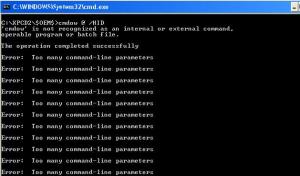

hi guys,
well i tried it out but i still have the same problem remaining..this is what i have :

and this is what i get :
(see the attached picture)
PLZ HELP ME :)
I copied what you had, and it works on my machine. Try turning on echo, to make sure the commands are working properly. The only other think I can think of is that you have XP home, and that might not work.
