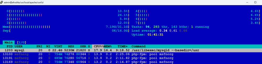

@xper Is this all just server overload?
ie, the gateway errors have NOTHING to do with the visitor's IP Address, but all about the CPU Percentage at the time of the visitor's attempted visit?
It is not entirely correct.
It's something among these. It's not a lack of memory.
The Backend Server is Down: Apache or PHP-FPM crashed or stopped running because of a configuration error or lack of memory.
Configuration Syntax Error: A leftover Cloudflare rule or file was deleted, but another configuration file is still looking for it, causing a processing failure.
A Connection Timeout: Invision Community 5 application took longer than 60 seconds to process a request (like rebuilding its Redis cache), so Nginx gave up and dropped the bridge.
Firewall Blocks: CSF firewall is misinterpreting the local communication between Nginx (Port 80) and Apache (Port 8181) as an attack and is blocking it.

Everything is sorted out regarding the bots, server configuration, and server security. Bots are blocked on 3 levels—scrapers and malicious bots alike, as well as those attempting SQL injection. Everything is working exactly as it should now.
Thanks for the advice anyway.

As someone who has spent time to investigate this somewhat recent issue of bot storms, none of that which was posted is relevant. These bots are not trying to register on the site, they are not the typical search engine spiders or spammers trying to post on the site. They are the result of large LLM farms from all over the world (mostly South East Asia last time I dug through an access.log) that are attempting to build their models. The legit LLM companies like xAI, Gemini, Co-Pilot, use legit tagging and follow established access rules such as robots.txt or similar. These dark LLM bots do not, and use proxies or Tor or other ways to reach a site.
They are not taking down sites by using common flood methods, aka access of ports, trying to log into the host (what fail2ban is for) or anything like that. They are viewing generated pages and using search fields. They end up taking down sites because those actions, while not triggering a flood edge, are causing connection limits and overhead on Database applications to hit their limit. Sites that heavily rely on a database application (such as a forum) go down because the db app goes down.
So far, the only ways to prevent this are to use aggressive blocking methods like Cloudflare OR tiresome manual settings. Or the absolute worst case scenario which is to set up a site to only be able to view generated pages if logged in with an account, and only show cached/static pages to guests.

I implement a two-step email validation process during sign-up, alongside manual approval (checking mail and IP for known spamers) for every new account. Server firewall also integrates five anti-spam databases to prevent malicious registrations along with IPS antispam feature.
Exactly. They are primarily scraping endpoints like /profile and /discover. Lately, there has been a massive surge in automated bot traffic originating from China, causing widespread disruption.
A single bot is sending hundreds of requests per second, whereas we previously had a few thousand bots across the site. This is crashing the database and taking the website offline.
They are running a Layer 7 DDoS / Aggressive Scraping attack.
Everything is fine now, and there is no need to bring this issue up again.
