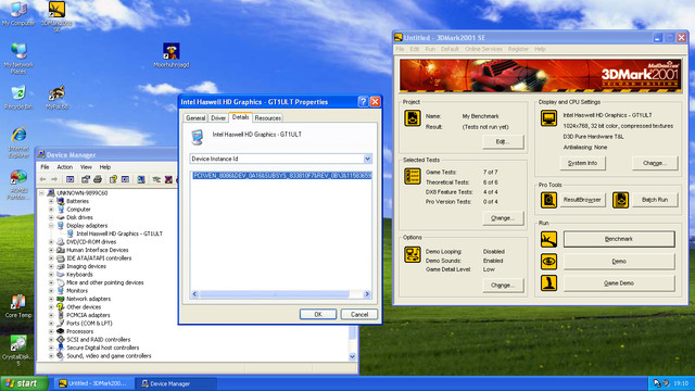

I am just installing Ramseys XP on the Panasonic CF-53 MK4.
I check, that it has exact the same HD 4400 with DEV_0A16 as yours.
Just now fun starts :)

@Damnation
After install of XP SP3,
I make a full USB-bootable copy to USB Kingston stick with AOMEI.
This helps, to put the original install always back to the beginning.
Then I set up the Lan Windbg for Intel.
I do not install the Lan driver i218-LM for this.
Here is the result, exakt as for you Bsod 0x50 after reboot of the Intel graphik 5445 driver.

Yessssssaaaaaaaaaaa!!!!!!!!!!! :cheerleader::cheerleader::cheerleader:
Dietmar
https://www.upload.ee/files/19651199/igxpmp32_5445_CF53_DEV_0A16_PPS5_NULLGUARD3_TEST.sys.html
I get 15781 points in 3DMark2001
Panasonic Toughbook CF-53 Mk4 – Intel HD 4400 DEV_0A16 under Windows XP SP3
I finally have the Intel 5445 XP graphics driver running on my Panasonic Toughbook CF-53 Mk4 with the Haswell-U Intel HD 4400 (PCI\VEN_8086&DEV_0A16).
This was debugged live with WinDbg over KDNET. The original Intel 5445 driver installs normally, but after reboot it crashes exactly like the system tested by @Damnation.
Hardware / software
Intel Core i5-4310U
Intel HD Graphics 4400
PCI Device ID: 8086:0A16
Windows XP SP3 32-bit
Intel XP graphics driver 6.14.10.5445
Kernel debugging via WinDbg/KDNET
The unmodified 5445 driver installed without any problem. On the first reboot, however, XP produced:
PAGE_FAULT_IN_NONPAGED_AREA BugCheck 50 Arg1: F000EEF3 Arg2: 00000000 Arg3: F000EEF3 Arg4: 00000002
WinDbg initially reported:
Probably caused by : igxpmp32.sys
The stack clearly went through igxpmp32.sys.
The interesting detail was that both the referenced address and instruction address were:
F000EEF3
1. Finding the real cause of BSOD 0x50
Initially I suspected a bad Haswell-ULT MMIO access.
We traced one suspicious Intel register read of offset:
0x64440
The live call was:
Context = 8A50F350 MMIO base = B8BFE000 B8BFE000 + 64440 = B8C62440
Immediately before the read:
ESI = B8C62440 EDI = B9B265A8 ECX = 00000001
The actual Windows function was:
nt!READ_REGISTER_BUFFER_ULONG
and the read completed successfully.
The returned value was simply:
00000000
So the 0x64440 MMIO access was not the source of the 0x50.
The important discovery came later.
In igxpmp32 we reached:
igxpmp32+171850: mov eax,[igxpmp32+26601C] push eax mov ecx,[igxpmp32+26601C] call dword ptr [ecx+90h]
The global object pointer was:
[igxpmp32+26601C] = 00000000
Therefore:
ECX = 00000000
Immediately before the crash we confirmed live:
with:
ECX = 00000000
Then:
dd ecx+90 L1 00000090 f000eef3
This explains the original BSOD completely.
The Intel driver was effectively doing:
ECX = NULL CALL DWORD PTR [NULL + 0x90] [00000090] = F000EEF3 CPU executes CALL F000EEF3 => PAGE_FAULT_IN_NONPAGED_AREA 0x50
So F000EEF3 was not a mysterious GPU MMIO address. It came directly from low memory at address 0x90.
We first tested the workaround manually by skipping the call and forcing:
AL = 0
The function returned cleanly.
We then replaced the six-byte call in RAM:
Original:
FF 91 90 00 00 00 call dword ptr [ecx+90h]
Temporary patch:
33 C0 90 90 90 90 xor eax,eax nop nop nop nop
This eliminated the original BSOD 0x50.

Success for me too!
https://ibb.co/yF15pPPr
Thanks very much!
Can you apply the same fixes you did to the 5449 driver too? (5449 is the last intel graphics driver released for XP as far as I know)
https://buzzheavier.com/9ktobfemwe7o
edit: Also, can you figure out why AGP texture acceleration is not available in direct X? I think it should be available?
Edited by Damnation
@Damnation
AGP Texture Acceleration = Not Available
is normal with Intel 14.x XP drivers, so also for the 5445.
Intel reports the graphics memory as local video memory, so DXDiag does not expose the old AGP/non-local texture path.
For to modd the 5449 I have no mood
Dietmar
  • Author
@Dietmar
Oh OK. I didn't know Intel's 14.x XP driver did that.
No worries with 5449 then, it'd good enough that you made the 5445 mod.
Yea, on my laptop ThinkPad X220 also no AGP Texture... available on Intel GPU 3000 - driver 5437:
