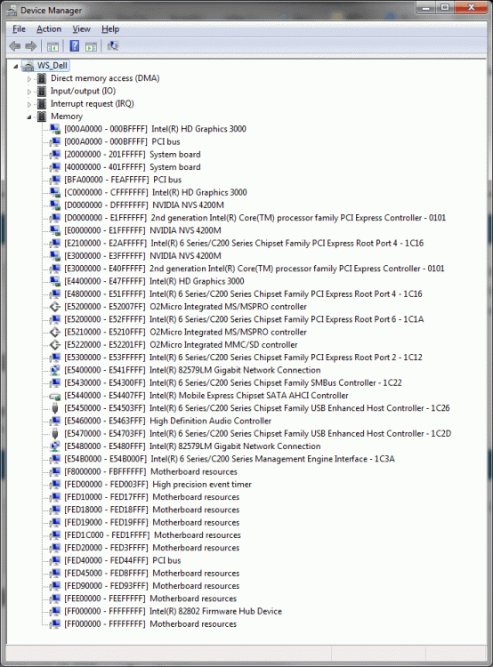

Well, here's what I've got:
I'm aware of those mods that get win-32 access to more than 4 gb, and how their success depends on the other drivers in the system - like the nvidia driver in this case?  Nothing else in this system aside from Intel chipset driver.

Those devices might work since there is no discrete sound card or other multimedia device, but might not given that there is no official Server available and they haven't had to proof their drivers for it.
You can see how the block C000 0000 to E1FF FFFF (256+256+32 MB) is reserved for video in addition to others. There seem to be two video cards active.
