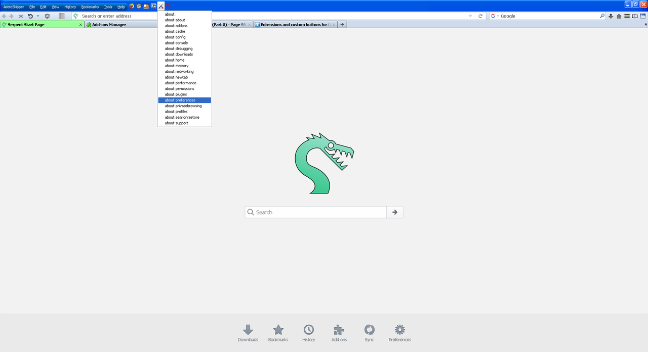

AstroSkipper Posted October 12, 2024 Author Posted October 12, 2024 (edited) @dmiranda What do you think about this custom button? Edited October 12, 2024 by AstroSkipper 4
dmiranda Posted October 13, 2024 Posted October 13, 2024 It does look quire complete. I forgot I'm using another button that I think came in the custom buttons addon I got from this thread, which opens about preconfigured to both open about: config on pressing the button, and allows to search for specific entries, preconfigured to look for extensions.yetanotheraboutconfighelper. This one you are now showcasing puts together that an the about pages as well. To a degree, the same concept as in pref toggler, which allows to switch on and off entries of my choice, thus consolidating many of the custom buttons you originally posted. Nice job!
AstroSkipper Posted October 13, 2024 Author Posted October 13, 2024 (edited) 10 hours ago, dmiranda said: It does look quire complete. Yesterday, I found this old button code in my archive. As the code of the button looked promising, I translated it and modified it completely. I changed the tooltip, totally reworked the menu of the important about: pages and added a help menu. I created a version for New Moon/Pale Moon and a version for Serpent/Basilisk/Firefox as some about: pages are different in these browsers. This button has a special feature. When selecting a string or copying a string to the clipboard, a middle-click onto the toolvar button opens it in the about:config page. All in all, it's a kind of recycling of old code so that it works again in our browsers. Thus, old code is not always useless and lost. And the code of this button is so universal that it seems to run in all Firefox-based browsers. Anyway! I will also post this forked custom button here very soon. Edited October 13, 2024 by AstroSkipper Update of content 4

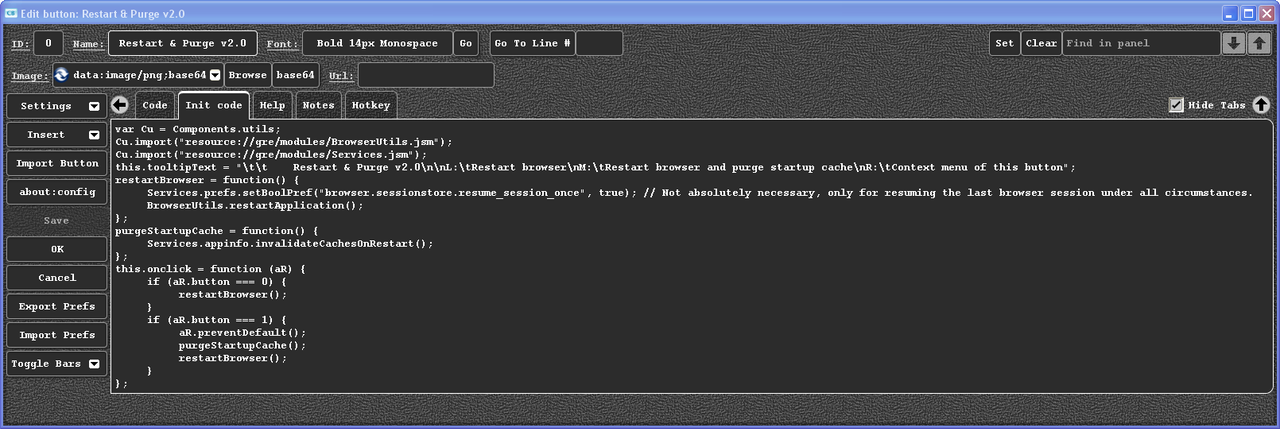

AstroSkipper Posted October 13, 2024 Author Posted October 13, 2024 (edited) Restart & Purge v2.0 - A custom button for restarting the browser and, if necessary, purging the startup cache, created by AstroSkipper Due to some abnormalities I observed when using my Restart & Purge custom button, I have now updated it to the version 2.0. I have changed and reworked the code considerably, and after a lot of testing, this updated custom button now works perfectly. One of the changes is that this new version of Restart & Purge now calls up the native restart code from the browser inside. The old version wasn't bad though, but the new one is definitely better and more compatible. I think there should no longer be any problems that could have occurred in very rare cases. Restart buttons are available in abundance and are nothing special. However, the most interesting feature of this custom button is the ability to purge the startup cache and restart the browser with one click. There are no corresponding extensions or functions with which the startup cache can be quickly deleted in the UXP browsers. In New Moon 28 not even the command line option -purgecaches works. So, an alternative way to delete the startup cache would therefore only be manually via the Windows Explorer or a file manager. My Restart & Purge v2.0 custom button performes a normal restart when left-clicked and additionally purges the startup cache when middle-clicked. Here is a small screenshot of my custom button Restart & Purge v2.0 and its tooltip taken from New Moon 28: As the code of Restart & Purge v2.0 has to be initialised, you won't find it in the tab "Code" but in the tab "Initialization code" of this custom button. Here is a screenshot of its code: And here is the download link: https://www.mediafire.com/file/1myts3tqkr6lgrv/Restart_%26_Purge_v2.0_10-12-24.xml/file The download link contains an XML backup file of the Restart & Purge v2.0 custom button as the problem with the conversion of custom buttons into XML format has been finally solved by me. Simply open the XML file in the browser and click onto the install button! For the installation of this button, the extension Custom Buttons is required which you can get from this post: https://msfn.org/board/topic/183923-extensions-and-custom-buttons-for-uxp-browsers-corrections-modifications-adjustments-and-special-recommendations/?do=findComment&comment=1226328 My custom button Restart & Purge v2.0 can be used with New Moon, Serpent, Firefox,even with the non-UXP browser Mypal 68 and some other browsers. And most probably also with Pale Moon and Basilisk (the call up of the native restart code should be the same as in the other browsers) which I can't test, though. Greetings from Germany, AstroSkipper Edited October 13, 2024 by AstroSkipper 3
