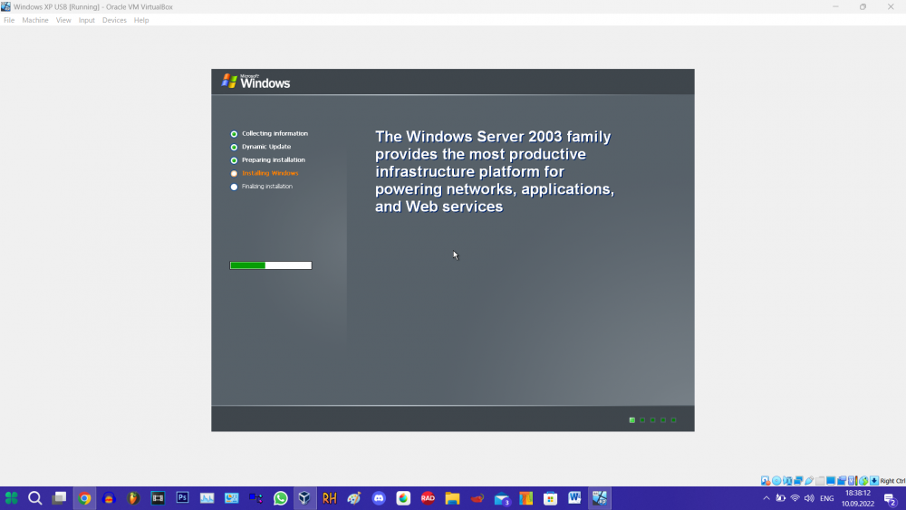

reboot12 Posted September 10, 2022 Author Share Posted September 10, 2022 (edited) @UsefulAGKHelper I have already checked it all in this topic: https://www.betaarchive.com/forum/viewtopic.php?p=434653#p434653 vbemp driver work in UEFI+CSM with Intel iGPU (I didn't test under pure UEFI with Intel iGPU) but I tested the vbemp driver under pure UEFI with the AMD 7450 PCIe card and unfortunately it doesn't work but then a normal AMD 7450 PCIe card driver for WinXP 64-bit works on pure UEFI I also tested a few NVIDIA graphics cards in UEFI+CSM mode (without GOP) and probably work with vbemp - I don't remember exactly but WinXP 64-bit on UEFI+CSM is not interesting and graphics cards without GOP will not work under pure UEFI. The screen from WinXP 64-bit in UEFI+CSM from vbemp or pure UEFI mode from amd7450 driver is displayed only from the moment of welcome: However, the Aurora boot screen is displayed using the graphics card firmware and winload.efi loader: Edited September 10, 2022 by reboot12 Link to comment Share on other sites More sharing options...
