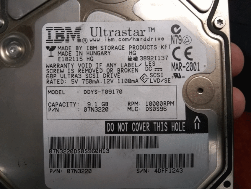

johnblood Posted September 18, 2020 Author Share Posted September 18, 2020 I uploaded images of the two drives. The IBM is the old drive that I want to mirror to the Quantum. I'm not sure how either are configured. Could you please explain what you mean by "properly terminated"? Both of these drives or on the same cable and the termination comes after the second (Quantum) on the cable. Another quick question: According to the SCSISelect Utility, the IBM has a capacity of 8748 and the Quantum has a capacity of 8683. Will this cause be an issue? Will I need to get a different SCISI drive? Thanks for all your help. Link to comment Share on other sites More sharing options...

jaclaz Posted September 19, 2020 Share Posted September 19, 2020 IF the IBM doc I found is the right one or similar, it has jumpers allright, only they are in the "inside". BUT IF ( it normally is) it is already set to be ID 0, it is fine and you can leave it as is. About the Quantum: https://www.seagate.com/files/staticfiles/maxtor/en_us/documentation/quantum_jumper_settings/atlas_ii_scsi_jumpers.pdf The "spare" jumper on the left should be left as it is in the scheme. The other spare jumper should be set vertically on the fourth column of pins from left, that should make it ID 1. OR vertically on the third column of pins from left, that should make it ID 2. Try connecting one drive at the time first the Adaptec BIOS extension SCSIelerct (Ctrl+A) should be enough to see the ID of the connected drive. About the mirror, the software one should mirror volumes, so, as long as the size of the volume "fits" it should be fine. We need to check the volume(s) size(s) and offset(s), to the byte, with *any* MBR/partition table viewer. jaclaz Link to comment Share on other sites More sharing options...

Goodmaneuver Posted September 23, 2020 Share Posted September 23, 2020 (edited) Adaptec SCSI Card 29160 is not a raid controller so you will have to use a software raid program to mirror the drive or use an auto backup program. What is disk1 by the way as disk1 OS assignment is not on the SCSI bus. Always have boot target ID as 0 set in the 29160 BIOS settings this will make the boot drive the lowest ID on the SCSI bus and always have the boot drive as the lowest ID on the SCSI bus. Ctrl + A will enter the SCSI BIOS on booting up the controller. Operating systems may write registry settings to lowest disk number on the SCSI bus if they are similar. You do not want to boot to disk1 for example, and then the operating system switch to disk0. The IBM has ID jumper settings next to the power connection. With the drive horizontal with label facing up, the first ID jumper bridge is from the RHS and if shorted so the jumper is placed like that shown on Delay Spin in the picture on the Quantum label, it will make it ID 1. The Quantum will need a different ID. Shorting SCSI ID 1 on J3 as shown on the label will make the Quantum ID 2. If no ID bridges are shorted then the drive will always take position 0 on the SCSI bus and as mentioned drives have to be configured to have different ID numbers. When entering the controllers BIOS settings there will be disk utilities where you can check the disk media for errors. Do not do a low level format. When hardware Raiding drives they should have identical sizes. Edited September 23, 2020 by Goodmaneuver Link to comment Share on other sites More sharing options...
