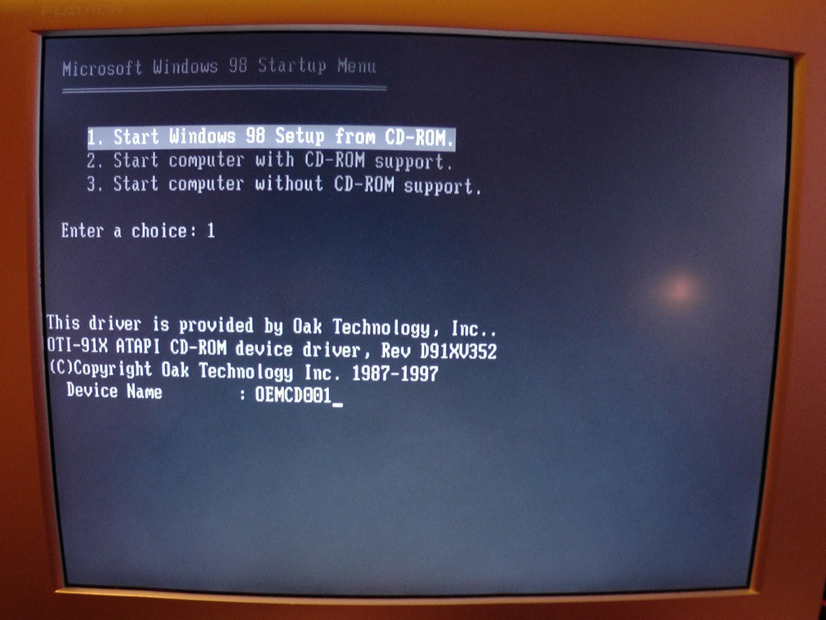

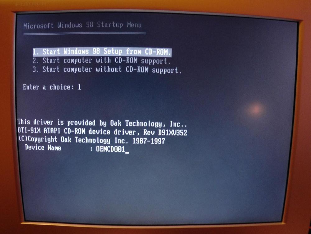

173a Posted February 2, 2020 Posted February 2, 2020 Hey everyone, I have this really strange problem with my win98 pc. When I boot from cdrom and try to either "start win98 setup" or "start computer with cdrom support" the disc spins up, a message appears saying it's trying to load some "oak technologies" driver for oemcd001 device and then it just stays there, the system does not freeze, I can ctrl-alt-del to restart and the cursor at the end of the message keeps blinking, but it doesn't load the driver. I used to be able to install windows 98 on this pc just fine, this is not the first time that I'm doing this with this very machine and my win98se cd, an original disc that came with an oem pc back in 2000. The pc configuration is as follows: asus p5pe-vm mobo, c2d 6420, ide cdrom, sata 80gb hdd. I've also tried it with 2 different ide cdroms now, configured as both master and cable select. The storage ports are set to run in "compatibility mode", if I set them to run in "enhanced mode", the system attempts to load the driver and fails (expected behaviour), so I know the drives are functional. The only change to this machine that I can think of, since my last windows 98 reinstall about 2 months ago, was the removal of a slave sata-to-ide adaptered 80gb sata hdd on the same ribbon cable as the cdrom, BUT I cannot see how it can make any difference since I've always disconnected everything but the cd-rom and my system hdd for windows reinstalls. Any ideas on what's going on are very welcome.

173a Posted February 2, 2020 Author Posted February 2, 2020 (edited) On 2/1/2020 at 11:05 PM, Wunderbar98 said: Hi 173a. Didn't see a comment on the condition of the Windows 98 CD. Under good lighting, any dust, dirt or damage? Can you hear the CD-ROM keep spinning up, like it's trying to read data but can't get a fix? The disc is in very good condition (has literally seen no use between 2000 and 2019) and it was working fine as recently as November maybe. I have also now tried it with a burned oem image and it's the same thing. As for the drive, yes - it spins up, it takes me to the windows 98 cdrom startup menu and then just does nothing. Edited February 3, 2020 by LoneCrusader removed link to unredistributable content
