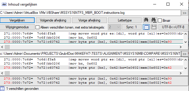

Tested two images of the 16MB USB drive in emulator.py. Bad news, but also really good news.
The bad news is that the log's of MSSYS16NTFS_MBR_BOOT.instructions.log and MSSYS16NTFS_PBR_BOOT.instructions.log showed only one difference:
DIFF_MSSYS16NTFS_MBRPBR_BOOT.instructions_log.png.2d2502b12ffc580120ecd591515e6fe8.png
So PBR-boot with 42h written at offset 2 and full BPB transplanted is not working in my emulator, it defaults to MBR-boot. Some highlights of the PBR-log:

The good news: only one byte has to be changed to force PBR-boot, showed in my disassembly of your code:
dualmbrbs.bin.txt
Start:
; --- Initialization ---
00000054  FA                cli
00000055  31C0              xor ax,ax
00000057  8ED0              mov ss,ax
00000059  BC007C            mov sp,0x7c00
0000005C  FB                sti
; --- End of Initialization ---
                                                ; reading from memory
                                                ; byte at address 0602h is unknown in first round and almost certainly is not 42
; --- CHANGE NEEDED in emulator.py ---
0000005D  A0027C            mov al,[0x7C02]     ; CHANGE !!
;0000005D  A00206            mov al,[0x602]      ; ??
; ---- END of changes ----
00000060  3C42              cmp al,0x42         ; ??
                                                ; if it is 42 then jump to the bootsector code otherwise continue as MBR
00000062  742B              jz Label            ; 0x8f = jz _BS_start
Now everything is fine, some highlights of the PBR-log:

1) sector is loaded (by the BIOS) at 0:7C00h but moved to 0600h (this is in the original makebootfat)
2) a check for 42 at 0602 makes it continue using the MBR code or the VBR code
3) since initially the byte is NOT 42 it continues with MBR code (that sets the 0602h byte to 42)
5) the MBR code execution continues on the copy at 0600h
6) and the sector is loaded at 7C00H
7) the SAME code (since it is the SAME sector) is executed but this time the byte at 7C02h (copied from 0602h) is 42 so it continues with the VBR code
Edited by jaclaz

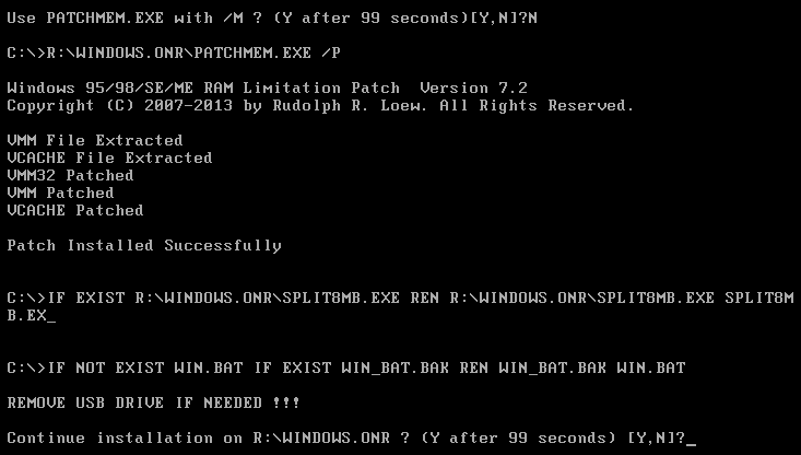

Third version of Part 8½ B: Full installation of Windows 98 Second Edition on a Rloew non-XMS Ramdrive
Most important changes:
1) PROTHOOK.VXD ruled out in favour of PATCHMEM /P
While working on Windows 95 versions of this project I found out PROTHOOK.VXD is not compatible with Windows 95, but PATCHMEM /P is working:
And what is nice in case of Windows 98: possible to start Windows in Safe mode on a Rloew non-XMS Ramdrive.

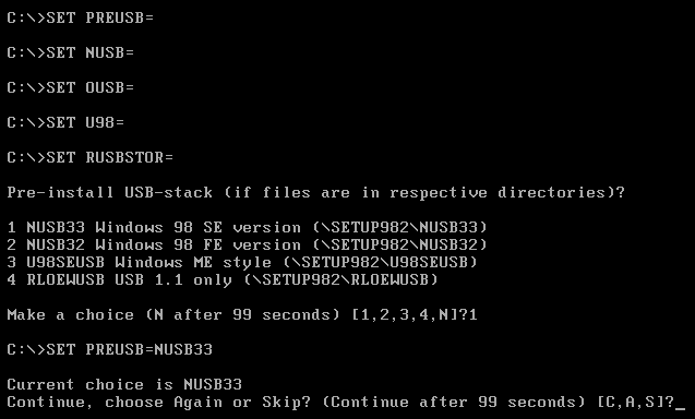

4) Added U98SEUSB from Problemchild's SP3 to possible pre-installed USB-stack's with a menu to choose (IF files are copied before to their respective directories by the user):
However, second phase of Setup will change a little because modded SYSDM.CPL from Windows ME is used in U98SEUSB:

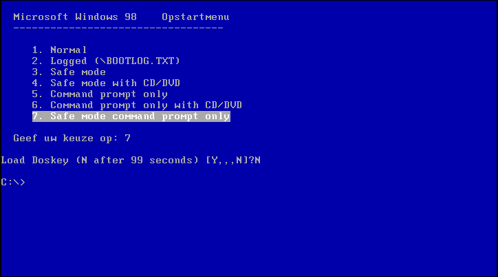

4) New Boot menu with choice to run Windows in Safe mode directly on the USB Bootdrive, with or without MS-DOS CD-drivers:
BTW language of header is dependent on IO.SYS' language.
