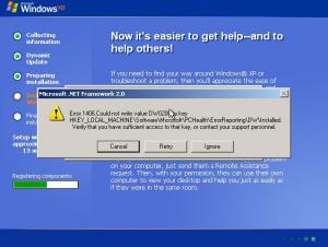

Outer Posted May 2, 2004 Author Posted May 2, 2004 sorry i forgot to mention that the method i used to install .net framework was from RunOnceEx because with xpcreate i could not install itEvent Type: ErrorEvent Source: MsiInstallerEvent Category: NoneEvent ID: 11406Date: 14/4/2004Time: 3:21:25 pmUser: N/AComputer: XXXXDescription:Product: Microsoft .NET Framework 2.0 -- Error 1406.Could not write value DW0200 to key HKEY_LOCAL_MACHINE\Software\Microsoft\PCHealth\ErrorReporting\DW\Installed. System error . Verify that you have sufficient access to that key, or contact your support personnel.For more information, see Help and Support Center at http://go.microsoft.com/fwlink/events.asp.i have used only the hotfixes that are mentioned on the xpcreate siteand like you said GreenMachine Beta software = you are on your own.so i will have to wait for the final version
Outer Posted May 3, 2004 Author Posted May 3, 2004 helloi have extracted the dotnetfx.exe then using the iexpress i have re-packaged the .net framework but there was a problem see screenshootyou will need to edit install.ini change CheckAdminRights=1 from toCheckAdminRights=0[Setup]ProductName=Microsoft .NET Framework 2.0ProductMsi=netfx.msiProductRegKey=SOFTWARE\Microsoft\NET Framework Setup\NDP\v2.0.31113ProductRegValue=OCMProductSupportURL=http://support.microsoft.comDefaultDirInstallToken=URTInstallPath.3643236F_FC70_11D3_A536_0090278A1BB8SupportWin9X=1MinNTVersion=5.0CheckAdminRights=0ShowFeatureOptions=0ShowDestinationFolder=0LogFilePrefix=dd_netfx20VerboseLog=1RebootMode=1UILanguage=1033BitmapFile=netfx.bmpCustomTextPrefix=CustomText
