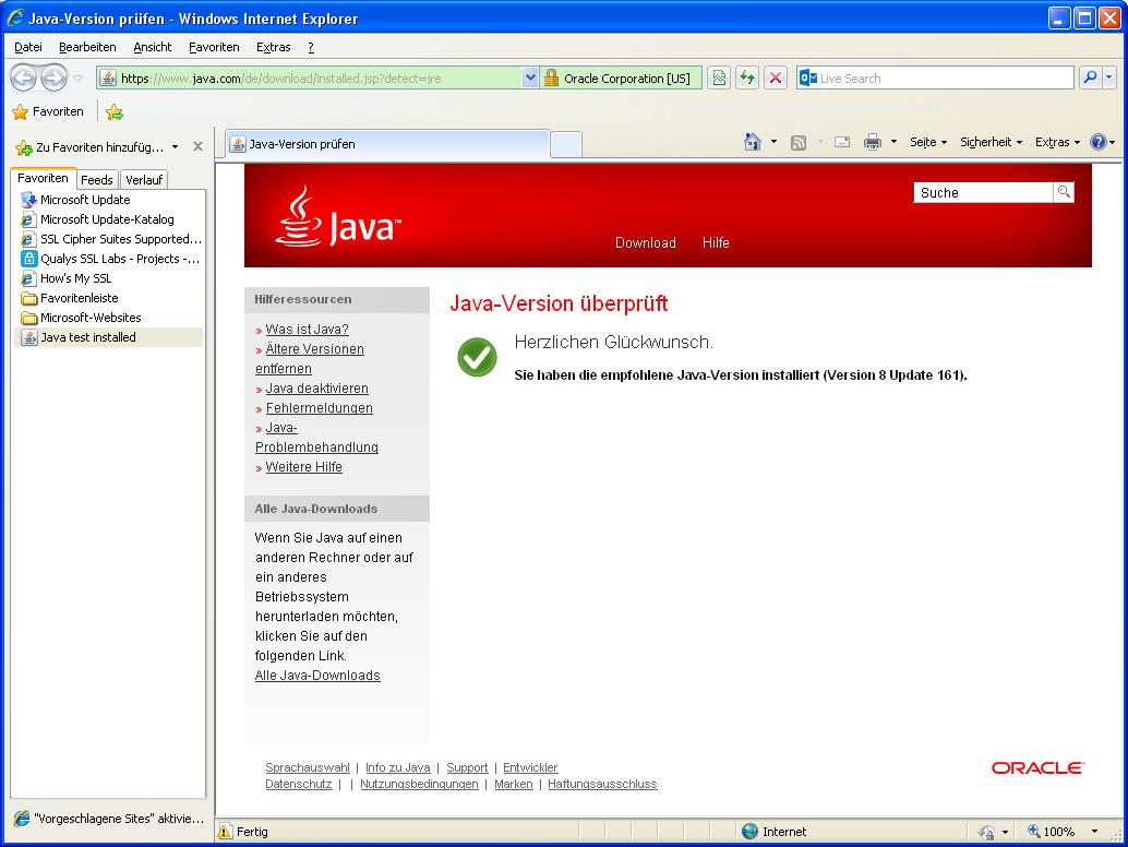

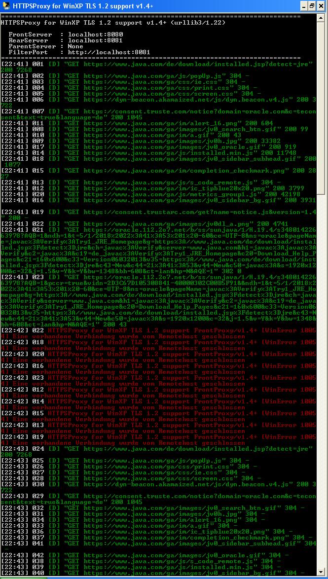

Thomas S. Posted February 5, 2018 Posted February 5, 2018 (edited) @all At this point I will inform that it seems that it is not possible to test Java in IE8 because of the min TLS (and / or cipher) versions Java.com support. I will do some research tomorrow and come back... But think about that it is not really necessary to have Java in any browser on inet by default - no need to use and to much security trouble ... If you have no problems to see the information presented on an site (with Java disabled by default in all browsers) you DO NOT NEED JAVA. That's the very very most situation at this time! For the moment quick and dirty: it works in IE8 if you have proper installed HTTPSProxy to support higer TLS / cipher versions in XP. Edited February 6, 2018 by Thomas S. test and solution

Thomas S. Posted February 6, 2018 Posted February 6, 2018 (edited) 19 hours ago, Yellow Horror said: So, the Java version 8u152 will possibly stay the last version supporting IE8? Wrong conclusion. You can see three posts above that Java v161 is tested as working on IE8. The (Java) test routine is automatically downloading from Java.com if You go to the Java test site on Java.com. To do so You need an working connection to Java.com But Win XP (and IE8) supports only older HTTPS (TLS 1.0), not newer protocols like TLS 1.1 / 1.2 ... It seems that Java.com has stopped old protocol support, so no connection by default with XP / IE8. To connect inet with XP / IE8 and new protocols You have to install special software - else You are lost. Easy description: The software (an HTTPS proxy) "convert" the old protocol to the new one and do basic certificate management. So You can get the connection and can download and test Java support in IE8. Other sites with Java code, connecting / running in "normal" IE8 will use the new v161 for sure... But this is a rather theoretical discussion, because IE8 does not support modern built sites anyway - and Java is even less used, so that is anyway rather useless. I have disabled Java in all browsers by default, never seen any problem with any sites content. I need Java only for one program that is written in Java script. Edited February 7, 2018 by Thomas S.

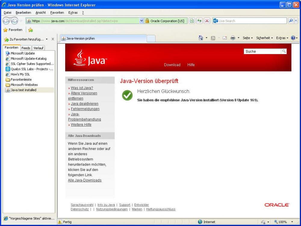

Thomas S. Posted February 8, 2018 Posted February 8, 2018 Here (above) I show that IE8 is tested OK with running Java v161: Java v161 running in IE8 There is Java code running and confirm the actual status of IE8 online with Java.com. So what You can understad is that Java is supported in IE8. Difficult to understand is why You can't test this with Your configuration. And I can't say, what is on Your configuration missing / wrong set. You have to understand that XP is not really a up to date platform that support actual HTTPS connection to inet. This was it I installed and configured with an HTTPSProxy to get a working connection to Java.com. And this has nothing to do with the support of Java in IE8, because it was the configuration of the external connection to inet that solved the problem.

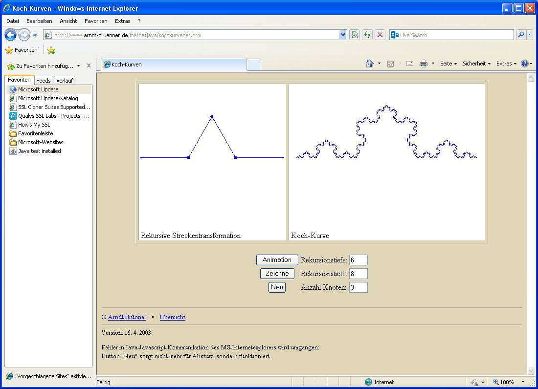

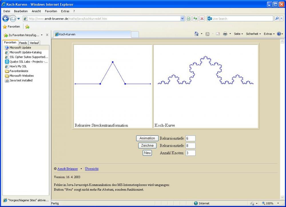

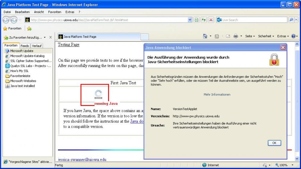

Thomas S. Posted February 8, 2018 Posted February 8, 2018 (edited) Can You give me the http site adress(es)? So I can look whats goig on there! I have looked at this site with http and it works (Java ist running), but then stopped because of my security setup (blocked also in FF 52 ESR). http://www-pw.physics.uiowa.edu/das2/javaPlatformTest.jbf.html#test And if I configure my security settings to run Java with an "unsave site" this is the result in IE8 (drawings with Java script): Edited February 8, 2018 by Thomas S.

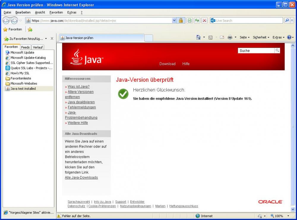

Yellow Horror Posted February 8, 2018 Posted February 8, 2018 On 06.02.2018 at 6:48 PM, Thomas S. said: It seems that Java.com has stopped old protocol support, so no connection by default with XP / IE8. I think, this is untrue conclusion, because the same test page works correctly w/o any proxy with Java 8u152 in IE8/XP.
Thomas S. Posted February 8, 2018 Posted February 8, 2018 (edited) 1 hour ago, Yellow Horror said: I think, this is untrue conclusion, because the same test page works correctly w/o any proxy with Java 8u152 in IE8/XP. You are right! Just tried the same test site, it works with Java v161 in direct XP / IE8 https connection. Three days ago not... So all Java versions properly working on my machine, very good! Edited February 8, 2018 by Thomas S.
