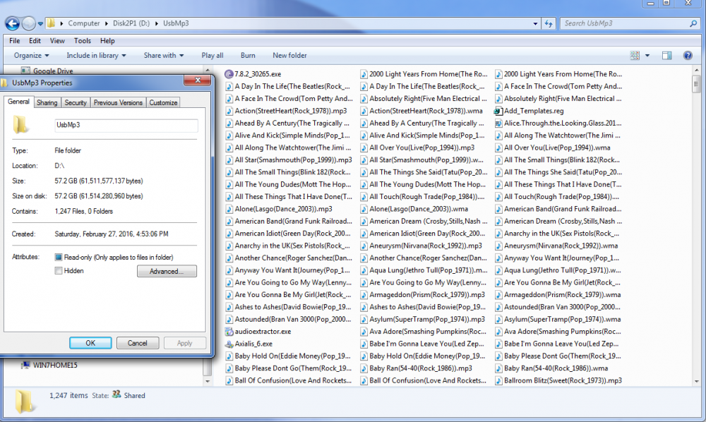

Here is a VBS script that meant to be run from your Desktop to a Folder and list it Contents. It then rename the file to a 4 digit number, it also produces a text file with the changes made.
1:\ Change This For Each i In Fso.GetFolder("D:\UsbMp3").Files, to the path of the folder
2:\ This script only is meant to be used with file that have only 3 characters and a period any less or more will cause an error

Rename TestListFiles.vbs.txt to TestListFiles.vbs to make active TestListFiles.vbs.txt
Resuts TestList.txt
