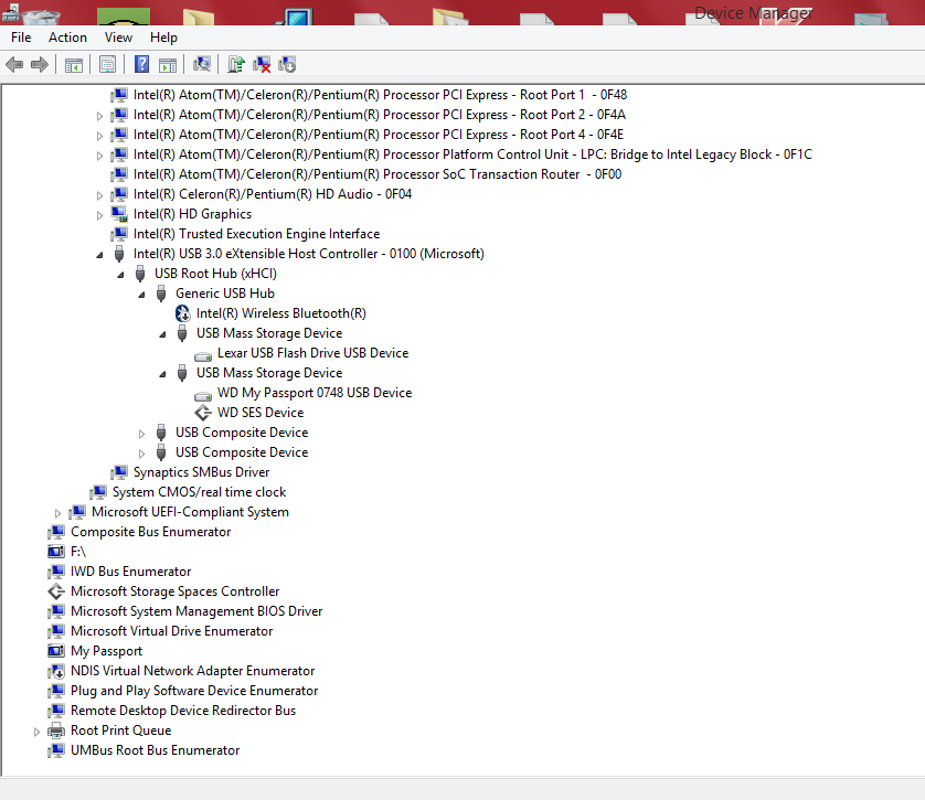

5 hours ago, Tsundere said:
-It was connected to usb 2.0
That's strange. The device is connected to a USB 3.0 controller.
A USB 2.0 port should be connected to a USB 2.0 controller. Strange HP?
Include Intel USB 3.0 drivers to boot.wim image 2.
https://downloadcenter.intel.com/de/download/22824
Version 4.0.4.51 contains %IUsb3XhcDeviceDesc01% = IUsb3XhcModel, PCI\VEN_8086&DEV_0F35, hence they should match.
Boot boot.wim. Does diskpart.exe detects different USB disks now?

@cdob Since this might be important, here are some screens of what happens when I plug in a WD passport and Lexar usb flash drive (F://) into both usb 2.0 ports. The last screen is the main change that happens when I click 'show hidden devices'. The WD passport has a total of 3 entries belonging to it, and the Lexar has 2. I am still in the process of doing the slipstreaming. I think 'Elements' is a different WD drive that is not plugged in.
