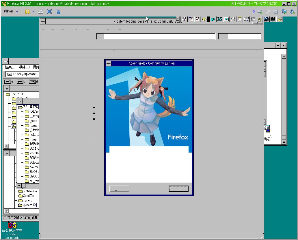

First BIG step of porting Firefox 3.6 to old NT.
It runs but it cannot show any text.
for Firefox 3 or later not working (exit immediately) on NT4, the biggest reason is that, NT4 doesn't like "Local\" or "Global\" namespace/prefix in the Mutex.
Test binary: http://roy.orz.hm/gpc/files1.rt/fx36vc71-20171014.7z

BTW I'm debugging fx36oldwin attempt to use NULL FontMetrics and crash in NT 3.51, many nsILocalFileWin changes are ported from 2.0 branch.

I was able to get the original firefox 3.6 work... It works well. Unfortunately the next releases throw an error and I need to fix them soon.

Oh nice. But mine is latest 3.6 (3.6.28) which changes alot. Still waiting for your wrapper release :)
BTW I found that NTSD is better than WINDBG in NT 3.51, which produces better stack trace (although I still can't find root of NULL FontMetrics pointer issue now).
It starts now, but no text and images (maybe cairo's problem?)
EDIT: With some testing, Text issue may because of usp10?
EDIT2: So Uniscribe doesn't work in NT 3.51 and throws 0x8007007F
EDIT3: GetCharacterPlacementW failed as well?
EDIT4: Tried GetTTUnicodeGlyphIndex() from MSDN, GetTTUnicodeGlyphIndex() itself works but I found that ExtTextOutW() does not support ETO_GLYPH_INDEX in NT 3.51. If I can't find a way to convert all related code back to non-glyph way, the project will hit dead end.
Test binary:
http://o.rthost.cf/gpc/files1.rt/fx36vc71-20171025.7z
Some fonts are able to paint in NT 3.51 now!
Test binary:
http://o.rthost.cf/gpc/files1.rt/fx36vc71-20171108.7z
