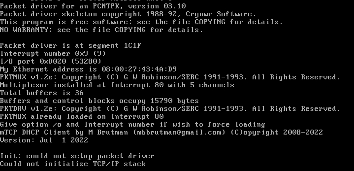

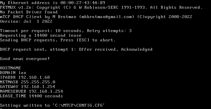

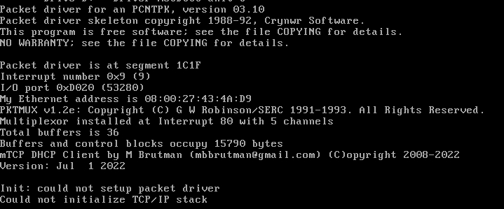

shelby Posted January 17, 2023 Posted January 17, 2023 (edited) i have this with INT number 90 I change the INT number to 80 and it give me this Edited January 17, 2023 by shelby

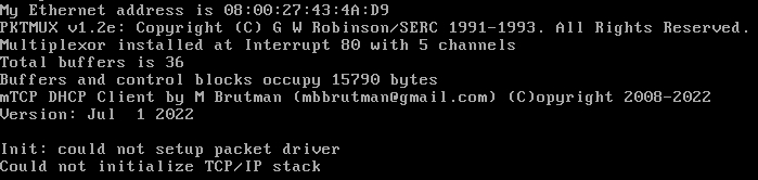

shelby Posted January 17, 2023 Posted January 17, 2023 (edited) ok but the problem with the PKTMUX still remains and it happens when the driver and the PKTMUX has the same INT number Edited January 17, 2023 by shelby
awkduck Posted January 17, 2023 Posted January 17, 2023 You need to change PKTMUX to interrupt 90. It is at 80 in the screenshot. Make sure you run PKTDRV before you run DHCP. You need to run PKTDRV before you run any program that needs the packet driver.
shelby Posted January 18, 2023 Posted January 18, 2023 (edited) With interrupt 90 it gives me this Edited January 18, 2023 by shelby

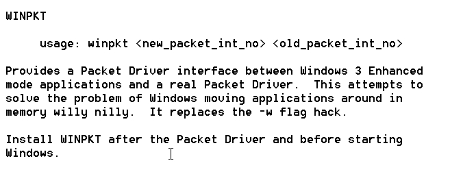

awkduck Posted January 18, 2023 Posted January 18, 2023 Have you tried? The PKGMUX.DOC (which is really just a txt file) says, Quote This document describes PKTMUX which is a program that provides a multiplexing interface to a Packet Driver. It thus allows several IP protocol stacks to be run in parallel either under DOS or a control program such as Windows 3 or DESQview. This files is included with PKGMUX. There is lots of good information in there. It is easier to use Trumpet. But even if you want to use WfW3.11 and the Wolverine TCP/IP stack, you can still get away with it. You just need to use a "packet driver" to "NDIS" shim.

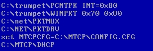

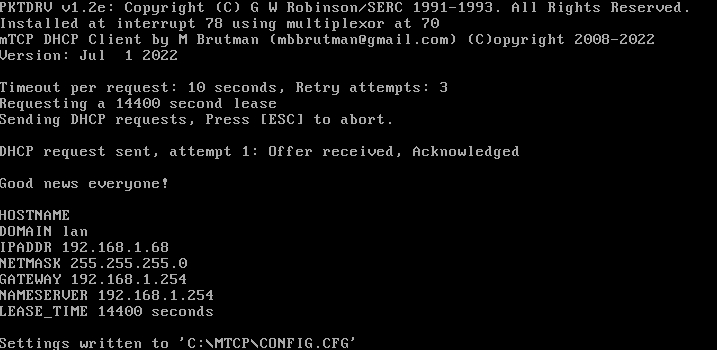

shelby Posted January 18, 2023 Posted January 18, 2023 (edited) I think this will be work. Packet driver to interrupt 80, PKTMUX to interrupt 80 ,pktdrv.exe and dhcp.exe in autoexec.bat Edited January 18, 2023 by shelby

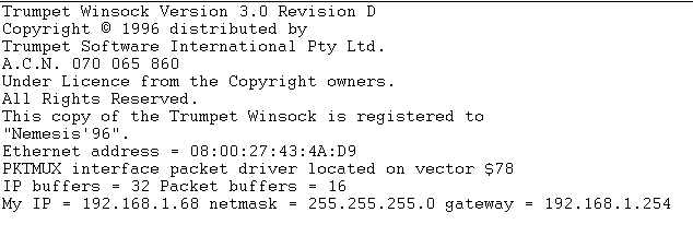

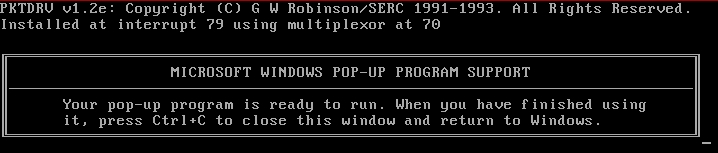

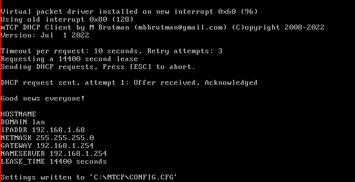

shelby Posted January 18, 2023 Posted January 18, 2023 (edited) Here is the complete line of commands in autoexec.bat that works And it gives this result when you run pktdrv in windows gives The trumpet gives Edited January 18, 2023 by shelby
