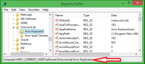

Avro is a software to write my native language Bengali. It stores profile settings under the following registry address and it’s only one address for profile settings. I made it’s silent install with registry settings for all windows version from XP to Windows 10. No problem with silent install but reg settings. It’s working everywhere. But for standard user (in Seven or later) registry setting is not working. That means Registry setting is not being added. If I can add the following registry settings with Administrator user I’m successful.
[HKEY_CURRENT_USER\Software\OmicronLab\Avro Keyboard]
post-322156-0-71640800-1416069148_thumb.

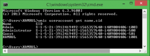

Exactly you’ve caught the real thing. I’ve two user account, Administrator and Standard. Administrator is password protected and Standard is auto logon user without passport. I always use standard user. It’s my active/logon user/KHCU. When I try to use administrative power (like installing/uninstalling etc) windows prompt for Administrator with password. It’s really my tricks to protect my PC from unauthorized or child attack. My all the drives are read only (Copy, paste, delete, move protected).
Standard and Administrator are the problem for my batch command. When I run the batch file from standard user/ active/logon user/KHCU it’s prompt for Administrator to install Avro. After confirmation of Administrator the batch file run with administrator user and try to add the registry settings in HKCU. In this moment HKCU is Administrator. But I need logon user. I want the batch file as universal command file for all kinds of PC (from Win XP to later, Administrator and Standard user). So how to run the batch file with the logon user in that moment? It's the command to use with Administrator and Standard/active/logon user. Thanks.
My user information as your command.
Yzöwl:
HKU\S-1-5-21-3912419492-1565357640-1409004406-1003
HKU\S-1-5-21-3912419492-1565357640-1409004406-1001
post-322156-0-46433400-1416144149_thumb.
