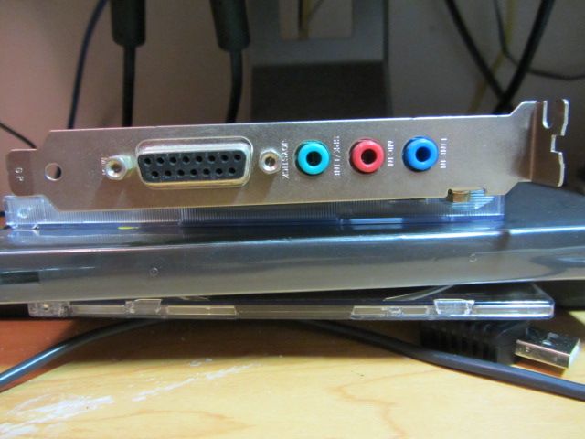

Hoko Posted May 4, 2013 Author Posted May 4, 2013 (edited) This Sound Card?http://www.amazon.com/CREATIVE-LABS-SoundBlaster-Sound-CT2980/dp/B004571LK2The Wikipedia link I gave claims it's a Vibra16 ISA PnP Value (no bass/treble).I was going more by the amount of I/O holes where you plug in. I've noticed the Vibra's have 3 and the 16's have 4. This one has 4. Don't even know if thats right, just an observation. But...As you can see the 16 is much larger and has more stuff on the board than the Vibra.The Vibra also only has 3 I/O ports.And the SoundBlaster 16 has 4.And the final verification is the label. Edited May 5, 2013 by Hoko
