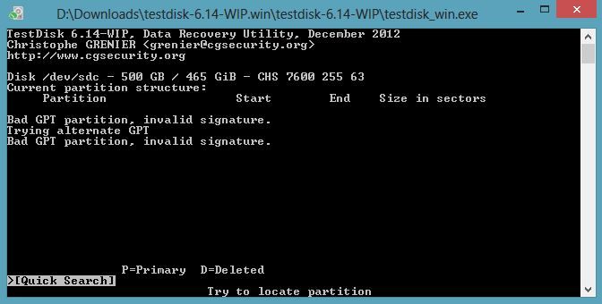

As far as it will let me go. Clicking quick search does nothing. Seems like it freezes.
edit: Apologies it just took forever to change to searching.

Hmmm. :unsure:
Even if DMDE can see the partition structure correctly I seem to remember that it doesn't operate (or doesn't operate fully) on GPT disks.
Time to try gdisk:
http://www.rodsbooks.com/gdisk/repairing.html
I have no experience with it, so I will be of very little help about it's use. :blushing:
jaclaz

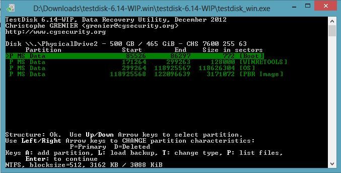

I must apologise I did edit my post but probably too slow: It did read and here we are:
Edited by blackillusion
NO need to apologize at all, but still we have "only" 4 partitions in this view AND we do have now a "new"[bOOT] partition that has however an "improbable" size.
Try pressing Enter and doing a Deeper scan...
In any case running gdisk seems like a good idea.
jaclaz
jaclaz
