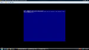

BUG FOUND: In the latest daily version of UUR 11: June 2013, I'm greeted by this terrifying sight:
post-357011-0-64711900-1372732723_thumb.
It seems that the kernel32.dll file is problematic.
In the April 2013 version, everything runs great. Super stable.
Thanks for testing. Something seems to be wrong in the latest kernel32.dll I've added recently. In what situation exactly did the BSOD occur?
