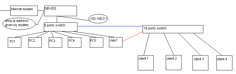

If all computers need to access DN1/DN2 (and the one that might cause a problem are pc1, pc2...pc5) then you should change your network setup using the dir 825 as router for all computers (even the win7) as shown in the attached picture. Then you can choose to connect the client 1/2/3/4 computers through the red or the blue line on the drawing. I would choose the blue one as all computers could access internet and your network setup would a lot either using only one private network subnet addresses for all your computers (and then use bridge mode for VMs).
post-85177-0-86750000-1317798362_thumb.p

My drawing isn't making things clear..
I have a connection from my modem to my router and my home network is attached to the router. The router gives me the possibility to give access to all my computers to the Internet.....on my Home Network
Original Idea
The windows 7 computer is getting a direct link from the modem (not going through router) and receives one of the 5 continually updating dynamic addresses my supplier gives out. I can't set my Windows computer with a static address if I am attached to that link.
My original idea was to avoid my network alltogether by giving the Windows 7 an independant link. To then install Windows Server 2008 r2 in VMware and make it my domain controller (with static ip for nic 1) then if I have understood this rightly we would need RRAS installed to give a static address.
I have also looked at creating a NAT router using RRAS, but there is a lot of conflicting info on the right way/wrong way to use RRAS
Would I create a vm with RRAS installed on(not sure which windows os) it and then create my domain controller which receives a static address from RRAS....?
Would the RRAS vm be just like an normal router outside of my domain?

OK! if RRAS is out of the question - then It would probably be best to connect the Windows 7 computer to the D-link DIR-825 router? Bexause of the firmware being dd-wrt I can turn off dhcp and just assign reserved ip's to my computers joined to the router. I am not a hundred procent certain how that works but maybe it is like dyn-dyns?
Now Assuming that I take this route my Windows 7 computer has now a static ip assigned to it even if I don't assign it physically on the Windows 7, but I can set the Windows 7 computer with the address reserved by my router.
So, now I need nic 1 from DN1 to connect to the Internet (with a static ip) and then my vm's that I use for creating my images XP, Vista, Windows 7 are joined to DN1 in the domain and can have Internet access allocated to them.
The (Physical) computers connected to the switch don't need Internet access, but do need access to DN1/DN2 for imaging via MDT, so I assume they will have to be in the domain as well?
I am sorry for repeating everything...just know that I we can get to the bottom of this it will be good info for others :blink:
Just bear with me and we will prevail
I like my (Original idea) with a NAT router to fix things...but even more uncertain how to proceed......HELP! :lol:

Your drawing is a lot better than mine, but NO that isn't the case of all computers needing access to DN1 and DN2......
My privat network is, just that, private and the only time I might need to connect DN1 or DN2 to any of the private network is when imaging and restoring.....on those occasions I can physically move them to the 16 port switch to image or restore and then put them back in my private network (not a domain)
Now I have been reading and reading.....help... :huh:
I have connected the windows 7 computer how I showed you and kept it outside my private network...I used NAT as you said, but I noticed something I hadn't seen before....DOH :ph34r:
After adding NAT for DN1 I ran ipconfig /all and saw what ip address vmware had allowed for my DN1. On this occasion it had allowed 192.168.235.128 and 192.168.235.2 for the gateway and that worked fine ....as it should...
I opened the Virtual Network Editor and changed the NAT settings slightly. I changed the start ip range given by vmware from 192.168.235.128, finish 192.168.235.254 to start 192.168.235.2 and finish the same at the moment and then changed the gateway to 192.168.235.1. I then set the default virtual adapter to a static ip adress 192.168.235.2 This gives me a static ip for my DN1 Domain Controller , so that I can install AD etc...
After making those changes I checked that things were working and YES I had a static ip without dhcp ready for AD!
Now, I haven't got any further with this exercise, but the dhcp from vmware doesn't conflict with my private network because we are outside of that....
Am I making any sense..... :lol:
So, if you can see a flaw in this way of thinking - then by all means say.....I am going to test AD now and then see if I can add vm's to my domain...then i can look at bridging the second physical network card for connecting my clients when needed....
I have connected Windows 7 as you showed and NAT works....now to adding machines to my domain....
bookie32
So the win7 isn't connected anymore directly to internet ? A DC shouldn't be nat-ed (so if possible you should use bridged in vmware) that why i was trying simplify your network and put all computer on the same subnet. If you connected the computer as i drawn it then every computer should have an ip 192.168.0.xx and could divide the subnet so all computers can see all ips and use more than one dhcp.
  • Author
High allen2
No, Windows 7 isnt connected directly to the Internet and I have activated dhcp in my router and according to your drawing.... I appreciate that a DC shouldn't be NATed as you put it.... :lol: , but I can't get bridging to work.....?!
It doesn't matter how much I read about it...I can't get an internet connection if I use bridging.....

The Situation Now:
OK! before starting any machines I can use the Virtual Network Editor and choose whether I want bridging set to automatic or choose which nic I want to use as my bridge for vmnet0...
The two physical nics are an Intel and Realtec (inbuilt). At present I have my internet connection connected to the Realtec nic (Windows 7)
So, I set bridging to use the Realtec....
Now under settings for DC1 I can choose "Bridge connected directly to the physical network"
At the moment I have just one adapter installed for DC1 and so that should be the nic that is used.....
When I start the vm DC1 I haven't any Internet Connection and I am supposed to give DC1 a static address? What else do I need to do to bridge from vm DC1 to the Realtec nic and be able to give DC1 a static ip?
I am missing something fundamental here but don' know what it is....?!

Well, I jumped off my balcony...two broken legs, two broken arms and having a hell of job writing this post..... :lol:
I have just been caught out by the most idiotic things that can cause problems when connecting to the Internet..........
ANTIVIRUS PROGRAM!!
I set up bridging again and checked cmd ...ipconfig and sure enough my router was giving out an address, but I couldn't get out on the NET. I tell my customers all the time about firewalls in antivirus software causing problems and I have been caught out myself :blushing::lol: I am feeling a right Rodney at the moment if you have seen the English comedy series Only Fools and Horses...
Rodney was a bit of a plonka!
This is so embarrassing!!
I am now going to set up my antivirus program with exceptions from VMware!
I still have a lot to do, but I now can start from my DN1 and work up from there...

OK! I install hyper-v and then begin to set up my lab...as mentioned before I would choose "external" to have the Internet access.....
Now I have my own full version of Windows Server 2008 r2 and that is where my questions start....
I don't really follow the parent child thingy :blink:
When creating the virtual drives I wouldn't be using the VHD you mention to download, so I need to set up everything so that each "server" has the right size disk for my builds etc....have you a suggestion?
Once set up I would use this lab all the time....and need to have the space for deployments/captures set up right.....?
Found the cd from Johan Awidmark....brilliant, but too much work for me at the moment and I don't need everything he takes up. What a learning curve that would be... :yes:
If you have some suggestions and things I need to think about from the above ...please say....
I have now my basic computer with Windows Server 2008 r2 and all updates installed....
Just a thought...the VHD what size disk is that set for or disks?
