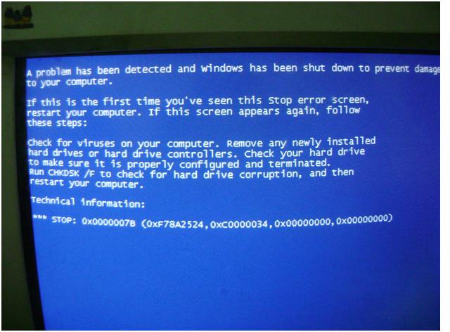

mudassar Posted April 15, 2011 Author Posted April 15, 2011 (edited) Hello Experts,As IcemanND said, i got the BSOD and screen shot is attached. Allen2 sir you are also right the as you said in the beging that problem can be because of hard drive driver. BSOD also shows same. KINDLY help me how i can solve tis issue now. SO OBLIDGED to all of YOU.I have connected that SATA drive with my Laptop now as external on USB and can explore its folders.... Please advise what to do now? Edited April 15, 2011 by mudassar
allen2 Posted April 15, 2011 Posted April 15, 2011 The right sata driver should be this one: http://downloadcenter.intel.com/Detail_Desc.aspx?agr=Y&DwnldID=17413&ProdId=2115〈=eng&OSVersion=%0A&DownloadType=.You just need to download it and download driverinjection gui then extract the driver to a folder and extract driverinjection to another folder and delete language.ini in this folder then launch driverinjection /language choose your prefered language and then follow the questions (Read this post to know more).
