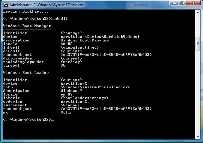

The F8 option is available only on Windows. That meaning you use the Windows BCD to boot into WinRE. So if you do not want to have Windows, you need another option to be able to selectively launch the WinRE partition. Also, the first thing WinRE does is look for an OS installed elsewhere. If there is no OS, I'm not sure what would happen. It reads from that OS to find out the user accounts and you have to log in to WinRE using an account username and password from the OS.
You may want to just use a modified WinPE to do this install rather than WinRE, as RECENV may cause you more trouble than you need.

You can try adding to that partition (when it is visible and with a letter assigned) a BOOTMGR and a \boot\BCD.
Then use BCDEDIT to add a suitable BCD entry.
Then you can try using grub4dos (loaded one way or the other) to chainload the BOOTMGR on the 0x27 type partition, but cannot say if it will work :unsure:
Check the links given here:

Review this:
you are probably missing some of the needed steps, as per SetAutoFailover.cmd, since you miss the option when booting, it should mean that you are missing the BCD entry, or maybe you used it NOT with the "alternate" (and working ;)) syntax found by Schiiwa:
page__st__31
