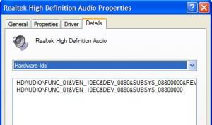

A way to quickly determine is to open Device Manager and do the following:
post-236786-0-13026400-1292967327_thumb.
Copying the Hardware IDs and searching for them will tell you for sure which device you need. You specifically need the VEN(dor) and DEV(ice) numbers.
E.g. VEN_10EC is for Realtek, DEV_0880 is model ALC880.
