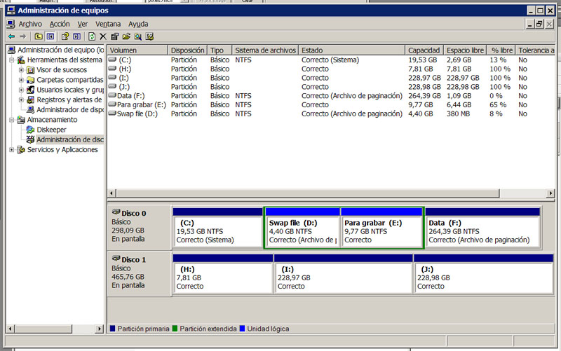

1 - I send you the screenshot of Disk Management:
post-308216-050806700 1288811298_thumb.j

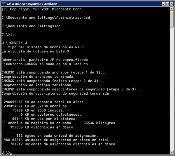

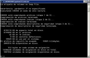

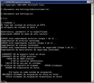

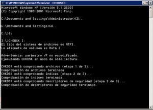

2 - Running CHKDSK I had to reboot several times and this are the snapshots:
From particion H
post-308216-049392000 1288811374_thumb.j
From partition I it hang in the middle all the times:
post-308216-085514600 1288811430_thumb.j
From partition J
post-308216-077400500 1288811483_thumb.j
