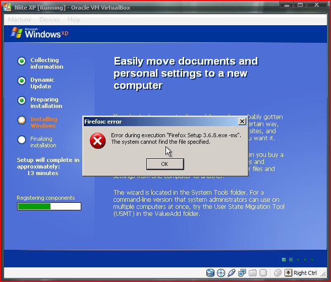

+ I tried doing something like the latest firefox. I get this:
The installer file is contained withing the cab file. I'm lost!

For Firefox, try removing the spaces in the setup file and rebuild the add-on.
Thanks for the Firefox tip .. I just replaced the spaces with underscores. Worked great!
