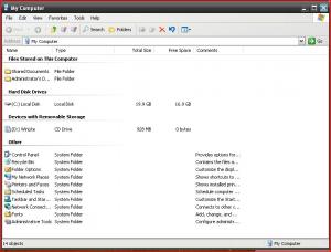

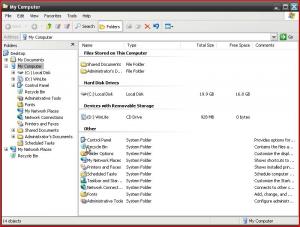

  10. Greetings! I cannot for the life of me find these few windows settings. The first of which is showing the folders in windows explorer. I appears like this after the install: When I would like it to be this: Makes it easier to navigate around. Second setting is the mouse. The mouse buttons are reversed. I have checked and unchecked the reverse mouse buttons setting with in nlite and it still reverses the buttons after the install is done. Why? Last but not least. How do I make it NOT install MSN Messenger and Movie Maker? Thanks for the help way way in advance! Attached is my LAST SESSION.INIfile.

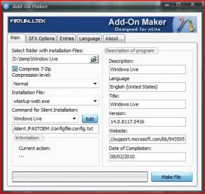

  12. I figured that much. Although once the install was done and windows was up and logged into I went searching for my installed program(s). Nothing. Here's the documentation from MS regarding the installation --> http://support.microsoft.com/kb/943595 This is a shot of add-on maker for this: And the config file looks like this: p=A26D7C8B-875D-48E2-BED1-7168268D022A*1, F81F501C-236B-4B4A-8E92-0575EAAD06FA*1, 31BB3B1C-5A3D-4E68-82A1-3C166F03C379*1&s=0&h=0&c=1&m=EN-US&t=1 Those three codes represent the windows live signon assistant, messenger and photo gallery. + I tried doing something like the latest firefox. I get this: The installer file is contained withing the cab file. I'm lost! I have attached the LAST SESSION.INI file to this post. Thanks for any help! =)

  14. I was trying to make an addon for the Windows Live install of just messenger, photo gallery and signon helper. I did a little research on it to make it silent install. I found all to info I needed. I created the addon with add-on maker. Had everything in one folder and the cab file was created. I did a simple XP installation and included that cab file with the hotfixes, addons and pack. Which I only had an addon. The XP install started and finished and never did I see any mention of it. Did't see anything. There has to be somthing I'm not doing right! Thx in advance!!!

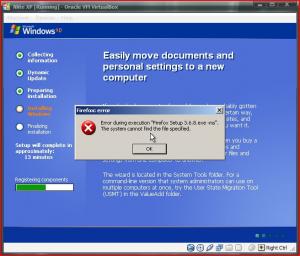

  19. Hi! Man, I really hate to sound so noobish, but, when I finally get to the step to create the install image and its doing the hotfixes there are many of them that want switches. I used nlite once before might have been a year or so ago but I don't recall having this problem. How do you get around it? Secondly, I saw some steps how you can include as addons things like Firefox, Thunderbird and others. This is the tutorial I'm talking about. When it gets to that step it wants to try and install Firefox on my machine. Bizarre! Hope you can help .. I appreciate it! Thx u much! p.s. I'll attache the preset file I had been saving through the process.Mimi PC.ini
