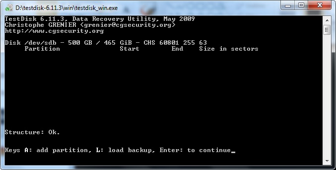

jiewmeng Posted May 12, 2010 Author Posted May 12, 2010 (edited) @jaclazthis is what i got (attached)is there a need to do "deeper search"? it took like nearly 2 full days to do a "quick" one ... i did a "analyse current partition structure and search for lost partitions" Edited May 12, 2010 by jiewmeng
jaclaz Posted May 12, 2010 Posted May 12, 2010 Hmmm, maybe I was wrong, and actually TESTDISK can "see" the drive even if it is in LBA0 or BSY mode, but it would be "strange".And no, I guess that for the moment the deeper search is pointless.Please reply to my last questions:On the desktop, with the "failing" hard disk connected directly, try going into BIOS and try "autodetecting" the drive, what happens?Once (even if slowly) booted to Windows 7, how is the "failing" hard disk seen in device manager?I still think about an intermittent problem, like a connection or the actual hard disk going bad. Is it noisy?Does it click repeatedly?jaclaz
