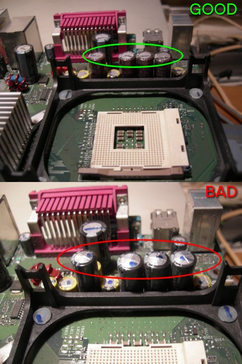

puntoMX Posted May 6, 2010 Posted May 6, 2010 It seems to do it mostly after the computer has been off for several hours.Apply new thermal-paste between CPU and cooler, other than, what CoffeeFiend said; that looks like a capacitor plague so check he ones inside the PSU and on the mobo .
VideoRipper Posted May 7, 2010 Posted May 7, 2010 Just to show you the difference between good and bad (blown) capacitors: Greetz,Peter.
