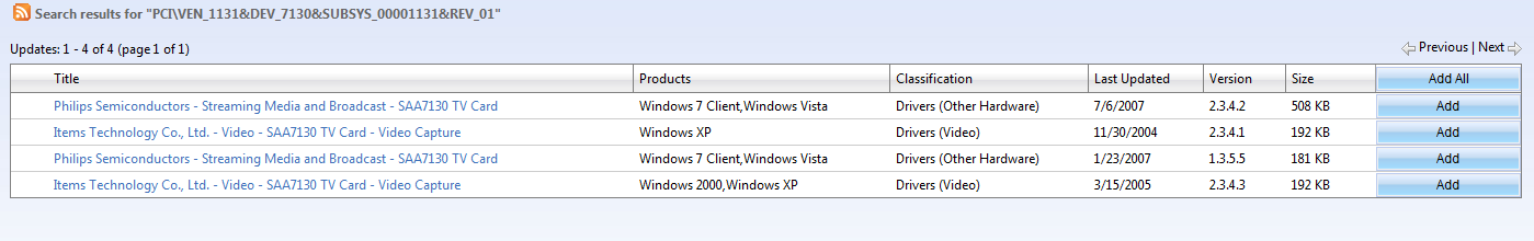

Semangka Posted April 23, 2010 Author Posted April 23, 2010 (edited) Thanks for the reply,I'm sorry i'm posting it from my workplace, actually the computer is at home.Yes, i think it is the software related. Because it has no problem on XP.Here's the PictureSo far i have been tested :installing DirectX 9.0c ---> still problem.installing original driver SAA7130 TV Tuner (From CD) ---> Drivers looks Okay.Drivers list in Device Manager shows --> SAA7130 Video Capture and SAA7130 Audio.When i ran the Honestech TVR 2.0 ---> BSOD then restart itself instantly.Then i tried to update the Honestech TVR 2.0 to Honestech 2.5 ----> still problemTried to update my VGA Card Driver (ATI Radeon HD4670) ---> still problemTried to update driver SAA7130 to the newer version (From the TV Expert website, Lifeview Website, and Philips Website) ---> BSOD dissappear. And drivers in Device Manager combine into one : SAA7130 TV Tuner.Then, i can hear all the sound flawlessly .... But Honestech TVR software shows only Black Screen.So far i have investigated is the Honestech TVR software (To play the TV Tuner) is working good, but the Chipset driver for SAA7130 is the really problem is.(ps. I'll correct the post later about the Drivers list name on Device Manager when at home, if there are any mistypos) Edited April 23, 2010 by Semangka
ricktendo Posted April 23, 2010 Posted April 23, 2010 These are the drivers on Microsoft Update Catalog (open in IE not Firefox and install the activex control)http://catalog.update.microsoft.com/v7/site/Search.aspx?q=PCI%5cVEN_1131%26DEV_7130%26SUBSYS_00001131%26REV_01
Semangka Posted April 23, 2010 Author Posted April 23, 2010 (edited) tried,But problem still exist i am start assuming that there is problem somewhere in my windows. Not in the drivers or tv application. Edited April 23, 2010 by Semangka
