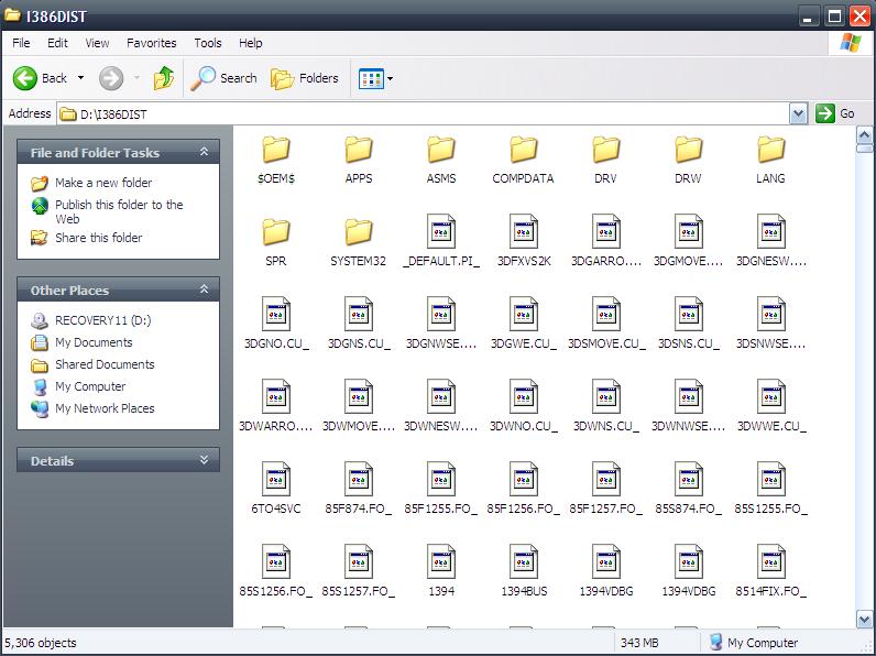

loala Posted March 12, 2010 Author Posted March 12, 2010 This is a picture of the Gateway Recovery Disc I386DIST File. Hope that helps I there no way I could have got it all in one picture of course. I figured the folders were what you wanted to mostly see.
submix8c Posted March 12, 2010 Posted March 12, 2010 (edited) Looks like that's the one... Lots of extraneous stuff there you may not want (e.g. the OEM folder). Probably the DRV folder is the OEM drivers, APPS is the pre-installed "Extras", and SP is additional HotFixes. The method (as depicted) appears to just "rebuild" the HDD (pre-install) then copy the folders onto it.To clarify, a normal I386 folder has -(files as seen)ASMSCOMPDATADRWLANGSYSTEM32WIN9XMIG (not needed?)WIN9XUPG (not needed?)WINNTUPG (not needed?)Won't swear to this, but nLite may accept it "as-is" (renamed, as MrJinje stated above). Edited March 12, 2010 by submix8c
